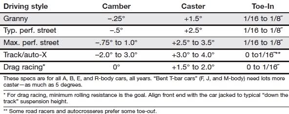

Finally, after you get the bushings replaced, you will need to get the car aligned. This chart from Allpar lays it out. Your car may not give you the ability to hit these numbers. If all else is well, take what you can get and run with it. My Custom would only let me adjust to +2º caster, so I went with it and the rest of the Max. perf. street settings. I'm a happy camper with it.

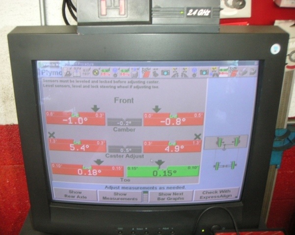

Autox: Did you use one K7103 bushing and one regular bushing on each side, or two K7103 bushings on each side?
Two on each side (one kit). I wouldn't skimp with just one offset per side. Because if you were just short of what you wanted, you'd have to take everything apart and redo the press-work. Not worth the cost of another kit vs std bushings.
I was able to get 5 deg positive caster, 1 degree of negative camber. So, lots of adjustment. If I went with less camber, could have got even more caster!
That is a lot of red for an alignment. You must have had your alignment tech steaming out of his ears with thoughts of this car is broken and I hate old cars. Seriously, though does it drive straight? With your cross camber and caster both pulling right I know it would have some drift with the road crown we have around here. The numbers on my valiant are very close to yours, but I got mine using rms uca's. Five degrees caster and manual steering makes you man up a little at parking lot speeds.
