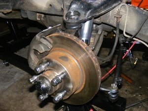

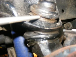

My threads were also getting worn,so I tac welded new ones in place.

I tac welded mine in place,the threads were still there but getting worn.I had a wet rag handy for cooling down after tacking.My car is for 1/4 mile only,not a daily driver,so I should be fine.Unless they pop out after wheelies?LOL:toothy10:
