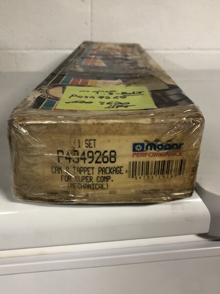

I found this picture in and old ad on A Bodies.
That’s nothing,,,,I don’t just have a picture of it but I have an actual kit that I bought years ago at the Mopar Nats,,,,,I purchased it probably 25 years ago and I’m guessing it is 35 years old or better .
Completely new,,,just opened to inspect,,,and taped the box back shut .
Top quality from good old Mopar .
Tommy
