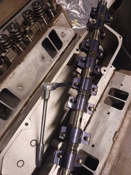

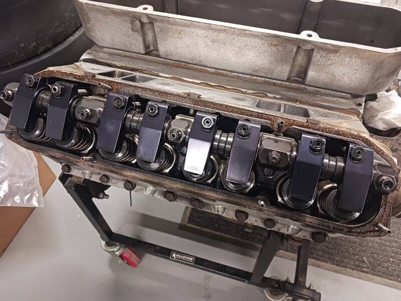

It's going to need a few rockers. The passenger side needs at least three. Driver side looks great. Pushrods look okay which surprises me
All 16 rockers have witness marks in the anodization from hitting the retainer. That alone warrants removing the heads to check the guides. Next up head bolts and valley cover. All of the rocker shaft stud nuts were backed off so there might be hope for the cylinder walls.

I think it's a fairly stock engine with a box of parts, but the only way you'll know is tear it down and document the thing. Compression ratio, springs, etc etc and build quality, torque values, clearances, WTF knows.
Just remember, that EVERY used, oily, "double hump" Chovit was a "Corvette engine."
Let me add that I'm not trying to crap on your find, all I'm saying is, that until you REALLY go through it, you won't know whether it's gold, or lead, LOL
Who’s rockers?
