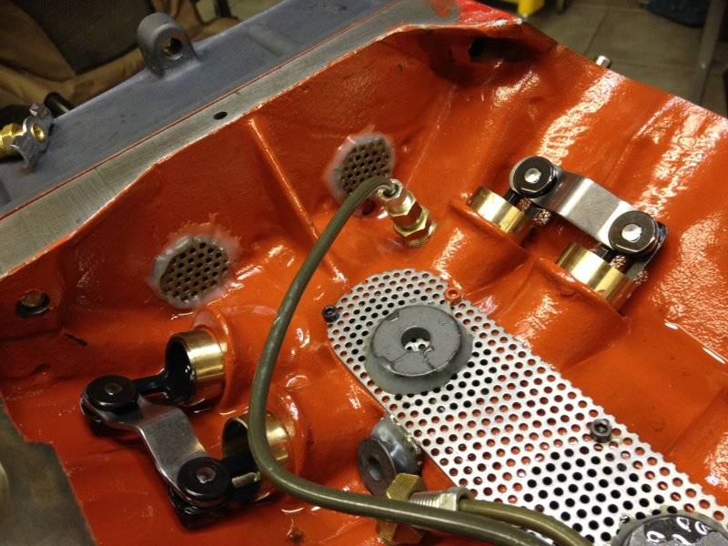

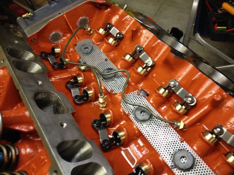

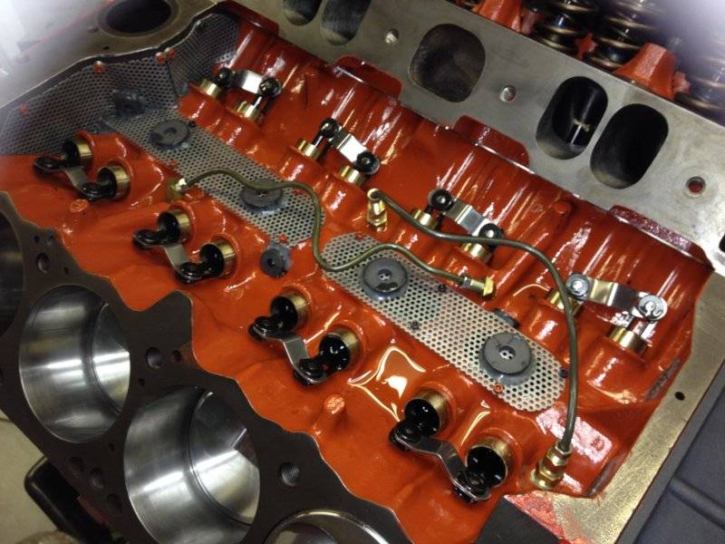

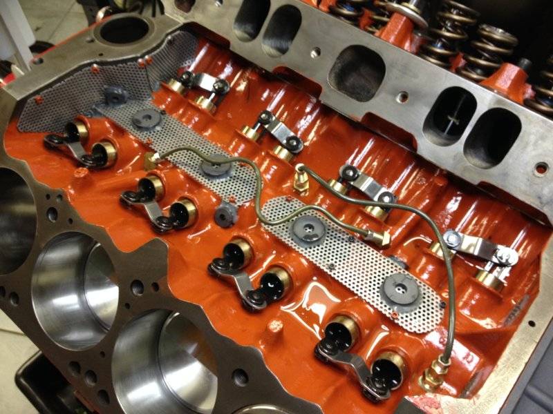

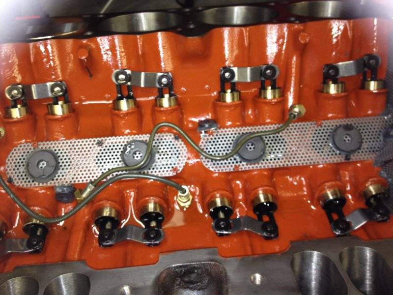

Just to add to this discussion, my current build I wanted to use the new bushed roller lifters from comp cams. These lifters have no needle bearings in the axle wheel and have an edm oil pressure feed hole directly to the bushing and axle assembly. As Pittsburgh racer has said I would never build a roller cam motor without a minimum of tubing the oil galley. Problem for me with these new lifters is they require some oil. With this build I decided to have the lifter bores bushed instead of tubing the block. The lifter bushings have a .030
Feed hole to restrict oil leakage to the lifters. The block will use a high volume pump. I have also eliminated the rocker oiling through the cam bearings and will direct feed right from the main oil galley
With a brake line jumper tube mod from the stroker small block build book. Also one brake line feed over to the driver side lifter galley
To feed the other bank of lifters.
Also these new comp cams sportsman lifters have the link bar located inboard, so no goring of the block and the lifter axles are staked so they have no snap ring clips to fail either.
I am hoping for the best compromise of reliability if the valvetrain
And good oil pressure for the bottom end, and no needle bearing in the oil pump and pan if you loose a lifter.

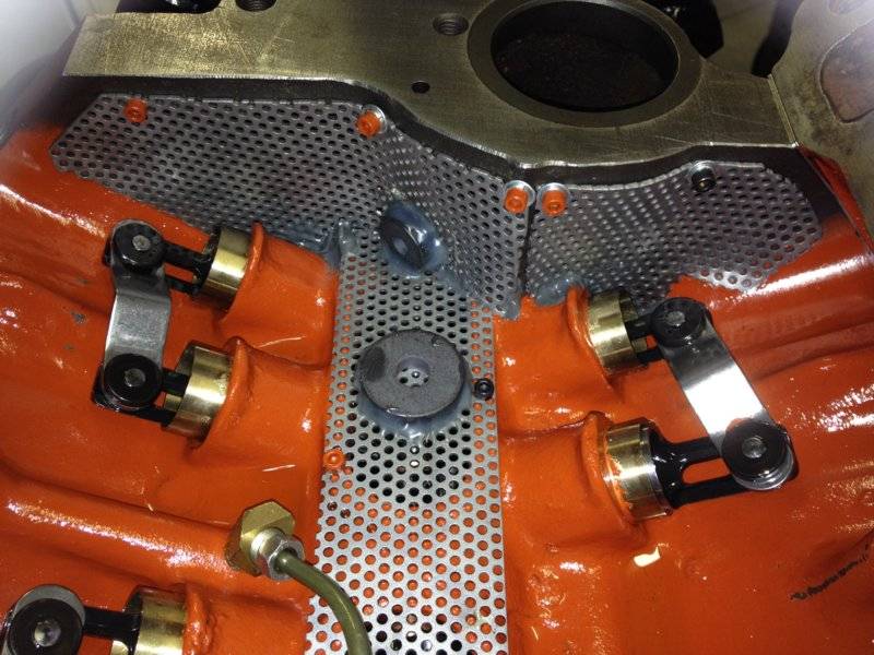

The magnets and screening are to try to contain the parts in the valley area and out of the pan. Those small needle bearings in roller bearing lifters are very hard to contain. Current theory is that with high lift cams and the necessary high pressure valve springs overload the small surface area of those needle bearings and that is why they are prone to failure. Using a bushing and direct pressure oiling should

Sure I don,t mind to explain.
Let me start by saying that both line have nothing to do with oiling the bottom end. At least not directly.
The "S" shaped brake line is tapped into the passenger side main oil galley. You cannot see it when the line is installed but that passage of the block the line is threaded into, intersects with the feed passage up to the rockers on both banks. In other words both banks of the engine are fed direct oil pressure full time from the main galley.
There is an .080 hole drilled inside the main galley that is feeding
The passenger side rockers and the brake line routes to the rockers
On the drivers side.
The other mod to go along with this is you must modify the 2&4 cam bearings. Those bearings have been rotated in the bore so the supply to the rockers is cut off. New 1/8 supply hole were added so the cam bearing still gets its supply from the crank. all five cam bearings have had the feed hole from the crank reduced to 1/8.
But the 2&4 cam bearings no longer feed anything else which will oil the crank better.
The other brake line is just there to get a supply of oil over to the drivers side oil galley to oil the lifters without using number 1 main to do it, Nothing more. The drivers side galley is not reverse flowed or anything and is plugged at both ends.
The bushed roller lifters require a constant supply of oil pressure so I could not run the drivers side dry. This was the primary reason I had my block bushed instead of tubed.
I hope I explained that so you can understand it.
