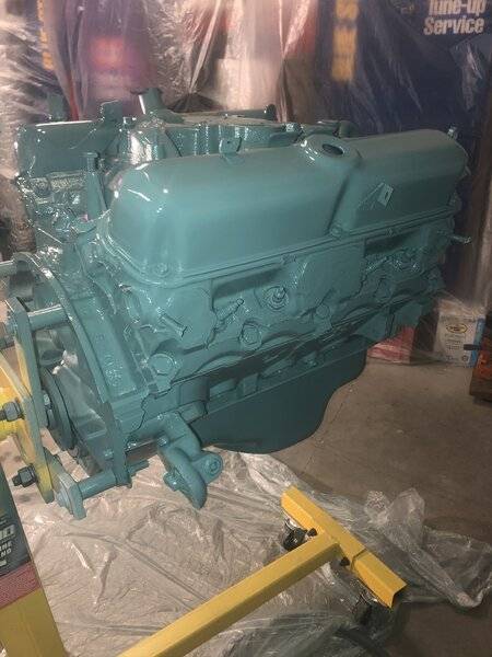

Big filter , lots of room , hope the photo helps , if you need pic of filter in the vehicle let me know
Thanks. I can see the alignment tab referenced in previous post. Looks like your right on it. Hope you put enough plastic down. I painted part of my office carpet. Yes it's inside.
Lol
My matching number block was painted in my garage . Paint was matched to a survivor 69 swinger . The paint on the block still looks like the picture 3 years later . Glad to help out
Lol

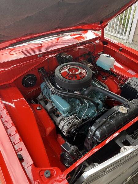

Clark, you are half correct. That color is for a automatic, Hemi orange is for the 4-speed cars. I have one and have a original dealer brochure showing it as hemi orange for the 4-speed.
All 69 swingers were turquoise. Mine is a 4 spd car . Still has original overspray paint on the clutch fork boot . However we have seen some oddball things coming out of the factory . Perhaps it was special ordered hemi orange ? Your engine bay looks great btw
