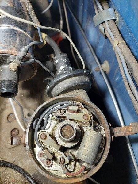

Working on electronic ignition conversion for HP273 dual point distributors
I too have the IBS 4013 cast iron dual point distributor and have had multiple conflicting answers from different Pertronics reps over the phone regarding their kits.
I've been told that I need the 1383, 1385, 1385 LM, and twice told that nothing is available that will work on my distributor.
Could you please reply one more time Toolmanmike as to if you also have the IBS 4013 and if the 1383 kit worked well for you? Has anyone else tried this specific combination?
Please keep us posted Valley Boy as to your results with this combination as well.

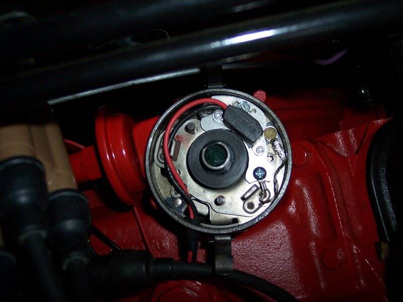

I used the 91383 in my '65 dual point distributor. No problems at all.
The 91383 is the Ignitor II version of the 1383 and has some improved features.

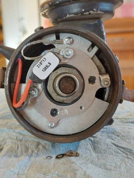

Here's a pic of the Pertronix 1385LS installed in my (1967 273) IBS 4013 cast iron dual point distributor. Seems like it fits to me... with rotor and cap on, the shaft spins freely, no problem.

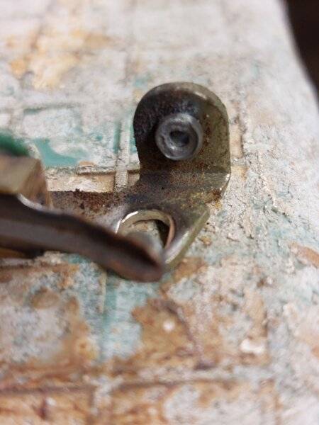

I did find slight interference between the vac adv arm and the adv plate. You can see it in the picture. I will be relieving just a bit of the arm in that area for clearance.

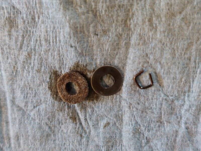

Also, there is a felt washer, a metal washer, and what I first thought was a home made wire clip for attaching the vac adv to the plate. I am now thinking that is an actual clip. Does anyone recognize it, or have seen them before?
On disassembly, the felt washer was on the bottom, with the metal washer above, then the vac adv arm, with the retaining "clip" on top. Does that sound right?
I had to loosen and rotate the silver ground wire to where it looked best to me, and the red / black wires had to be pulled through the grommet for what seemed to me to be the right length. Hopefully those wire won't rub on anything and cause a problem.
There is no adjustment on the pick up, so it must be fine? Also, there is a white sticker on the face of pick up... not sure what to think of that? In the pic you see one sticker on top, but there is one on the sensor surface as well. I may remove that one later.
Upon verification that the unit does fit, and all seems well, I have ordered a 40001 (chrome) coil, and 708180 stock looking plug wires.
I have been advised by Pertronix to bypass the ballast resistor at this point, which is fine by me. One less weak link to worry about! I will leave it in place to keep the stock look.
View attachment 1715824156 View attachment 1715824157 View attachment 1715824154 View attachment 1715824155 Here's a pic of the Pertronix 1385LS installed in my (1967 273) IBS 4013 cast iron dual point distributor. Seems like it fits to me... with rotor and cap on, the shaft spins freely, no problem.
Thanks for the update. You will be on the road soon. That crazy clip could probably be replaced with a E clip depending on what the groove on the advance arm looks like. Nicely done!

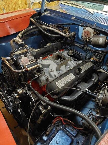

Pic is progress so far;

I also realized, after carefully relieving that area of interference on my vac advance with pin grinder (it came out nice!), that the diaphragm was blown...oops, I guess I shouldv'e checked that first?
