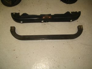

Here is a pic of mine.
Boxer, what did you do with your radiator. On my car the radiator almost sits on the bottom of the existing support. The tubing you have would require the radiator to sit about 2" higher and would interfer with the hood. Or would require a custom radiator.
Looks like he probably has an alum rad with side tanks. I have a convention style rad, so mine will sit a little lower, but be barely visible behind the spoiler.
dgc333, yes it was a bit of a hassle, I had got a large be cool rad and figured out it was to high. I talked to them and they said they could remove 2 rows (I think), and it would give me an extra 1.75 inch. They were reasonable and did it quickly, and all works great. I have put 1200 miles on it so far, man is it a blast to drive. I will get some pics of the completed car soon. I have been so busy with work and family stuff, haven't had time to post. Anything else, just let me know, take care, Ed.

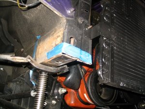

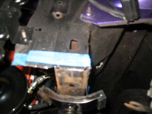

Here's some shots of the install. Once the valence, bumper and rad are out of the way, I carried a line from the bottom of the frame rail across through the support.
