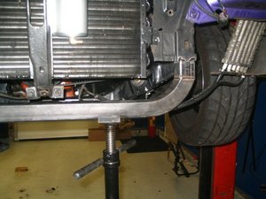

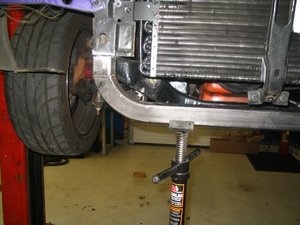

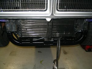

Once set in place equally on both sides, weld the support to the bottom of the rails. I used the hole just behind the support to make sure its straight. Many of the holes in the frame of our cars were put there for measuring purposes.

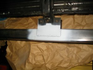

In order to pick up the center latch support, I cut a piece of plate and drilled the 2 holes like the original. Bolt in place and tack, so it fits, then finish the weld.

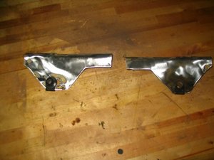

Once the center is done, there are two more tabs on the 70-72s you will need to pick up. I cut those sections out of the original, then made some extensions to bring it up to where it would meet the valence. This can be done with flat plate for a neater appearance, but this material was handy for me.

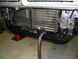

Since I need clearance for my stock style rad. I welded on the included extensions.
does it look like it will make any clearance issues? Or would your bumper hit before the rad support?
Im interested to see how your car will handle now. Also if it hits any of those parking bumpers or bottom out on the driveway dips.
Nice job with it! can't wait to see it with everything back on and at ride height! =P~

nice! didn't stick out as much as i would think
how is the test drive?

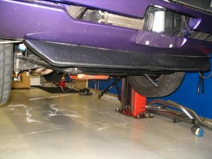

It didn't stick out as much as I thought it would, but the spoiler covers most of it. No test drive yet, as I am doing other things for a bit.

Car is up and running, and I have to say I am always impressed with the results any type of chassis stiffening makes. Especially on my own car, where this was the only change made. I've had this car 26 years, and it is very clear that this part really reduces creaks in the front end of the car. Since I've had 1.04 t bars for 15+ years, I am well aware of the toll it takes on the unibody. A positive unibody reinforcement for any A body!
