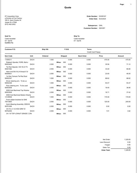

@HemiDenny , @DionR , @75slant6 , check this out! This is another Ride Tech product that come with their Mustang kits. It uses a S550 Mustang hub, so the bolt pattern is 5x4.5. They also have a caliper brackets that will allow the use of the S550 brake components. I'm not seeing these parts listed individually on their webpage, only included in kits. I kinda wish I would have found this earlier. This open options to use a factory Brembo caliper and have parts store availability for replacement parts.
I called ride tech today and asked if these spindles are available outside of the complete kit and the rep I talked to (George Lewis) said they are and he’d actually just sent a quote to another customer a few days ago, so he just forwarded my the same quote to give an idea on what we’d be looking at for cost. Here it is.

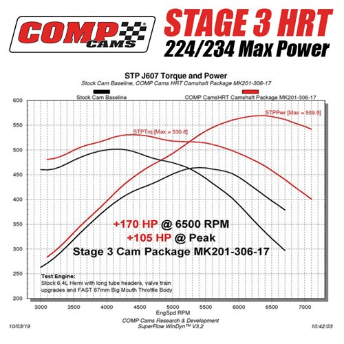

When you consider that the 6.4 is already rated (probably under rated) at 485hp in a stock "car", it's easy to believe that just adding a good intake, headers and a canned tune.. you're there at 500hp mark. I mean, we're only talking about grabbing 15hp. Alot of really good cam options with MMX, HHP, FRP that should easily put a stock rotator 6.4 at 550 with a good tune. But really, a 5.7 is just as sweet.. Amazing bang for the buck! If you haven't went for a ride in Tim's car since the upgrade, you should. Unbelievably smooth and the power is anywhere you want it. My Dart with a 6.4 is a slob but will make you smile and laugh with a vulgar display of power and torque, as the bench seat has it's way with you.. but Tim's, it really let's you see the full potential.

Yeah, this was the cam dyno chart I was referencing which is way more than you could put down well in most handling based A-bodies:
But you are right, the 5.7 with mild mods is a monster as well. it's the Hemi head flow that helps. Especially the Eagle ones.
Really my main concern is by the time you add all the supporting mods/swap parts for a Hemi you are in and extra 3-5k over your engine.
