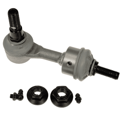

I'll also ditch the poly bushings and go with heim joints.
I like the modern balljoint style connectors myself.

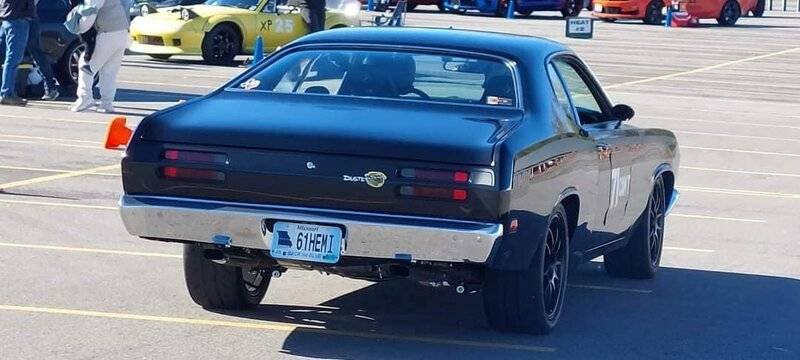

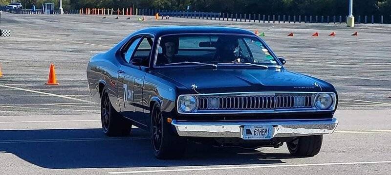

In October, after MoParty, I moved DOWN a size from Michelin Super Sport (300 Treadwear) 255/40-18x9, 285/35-18x9.5 to Falken RT660 245/40-18x9, 275/35-18x9.5 (200 Treadwear) tire designed as a very stretable autocross tire. The difference in grip was night and day. I was just fighting the car the entire time with the Michelins, sliding around almost every corner. I wore the front tires down to the wear bars in 2300 miles of street and autocross! The good news, I'm no longer fighting the car and dropped almost 4 seconds off my time with the Falkens compared to my other CAM-T coopetitors, and I can run higher tire pressure of 39/36PSI! I'm expecting to slice a few more seconds off my time next spring while I upgrade to sliders for my rear springs before I bend the offset shackles.
Tim, as usual moved from the Falkens RT660s I just upgraded too, and now runs a larger footprint Bridgestone RE71, which are still on the edge of streetable, but known as the best autocross tires for the past several years. That may likely change this year with new Hoosiers coming on the scene. I would guess the RE71s are worth about .50-.75 of a second on a similar autocross course. So, until I get within a second of Tim on the same course, I don't have any excuses but my driving ability. I've already chopped off 10 seconds from my quickest time last fall due to various upgrades and better driving. We'll see where we stack up next year.
For those those that haven't autocrossed, it's hell on these old cars. I even loosened ALL of my K-member bolts within 24 passes and have now added checking those bolts which are torqued to 150FTLBS after every event, typically 6 runs. Autocross is like turning into your driveway at 35MPH, actually borderline violent to ride in AND we can give rides with just a helmet required. In others words, it's a hoot! I can't wait till spring!
In October, after MoParty, I moved DOWN a size from Michelin Super Sport (300Treadwear) 255/40-18x9, 285/35-18x9.5 to Falken RT660 245/40-18x9, 275/35-18x9.5 (200 Treadwear) tire designed as a very stretable autocross tire. The difference in grip was night and day. I was just fighting the car the entire time with the Michelins, sliding around almost every corner. I wore the front tires down to the wear bars in 2300 miles of street and autocross! The good news, I'm no longer fighting the car and dropped almost 4 seconds off my time with the Falkens compared to my other CAM-T coopetitors, and I can run higher tire pressure of 39/36PSI! I'm expecting to slice a few more seconds off my time next spring while I upgrade to sliders for my rear springs before I bend the offset shackles.
My plan on the '73 Hemi car is to use LCA's without the swaybar mounts and build a mount up higher so I can run links that don't need to be modified. But that's a project for after the car is running and driving.
I've considered going this route as well. I would have to use the one with one side 90 to the other like this one. I would need to figure out that taper and simply drill my arms to match.

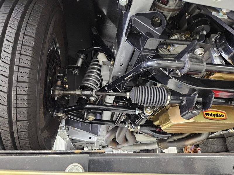

It is bottoming out and it was before I even put this setup on the car. If you look close at the second picture, my inside rear is slightly off the ground. Ths only happens on high speed sharp turns. Denny supplies a 1" solid sway bar, the Hotchkis bar I used to run was 1.5" hollow. Using the Addco online sway bar stiffness calculator, there's a significant stiffness difference between the two. A member here, @bjkadron volunteered to help me do some mathing once I get him some weights for him. I'm going to make a splined end tubing type sway bar and I want to make sure I pick the right size tubing. Had he not volunteered, I would have just gone with the same size tubing the Hotchkis bar has, 1.5" x .188" wall. I may end up with that, but at least I'll have some math behind it instead of just guessing.
Yeah, I need to get to work getting all that math into a spreadsheet. I'm hoping to have some time to do that over the Holidays. I'm curious what we come up with. Should be a handy resource for me once I get it done too.
Yes, still have the 450lb springs. That's another thing that Benjamin will evaluate for me. I don't want to go too stiff on the spring if the bar can make up for it. After all, I still street drive this thing and I wouldn't want to make it so stiff that it becomes unpleasant. I'm going to scratch make everything for the sway bar and I'll detail it all here. I figured out a relatively "cheap" solution. The base of the design will be a larger diameter tube that spans across the current mounting points to add some rigidity. That tube will have bushings in the ends that can be swapped out to match the diameter of the actual sway bar tube. I also plant to have a few holes in the arms so I'll have some finite adjustability. I'll also ditch the poly bushings and go with heim joints. I'll have to see if those end up being too harsh for street driving. If they are, I can simply make up something with a bushing for one side and swap it out when needed.
My initial thoughts are that it is mostly your roll stiffness that is giving you trouble. I'm hoping to get to an event in person soon but at moparty and in pictures I don't really see issues with fore/aft weight transfer so I'm thinking that it is just the change is roll stiffness that your lower roll center, combined with the smaller swaybar threw off the roll couple front to rear. Increasing spring rates too much will just make the ride worse and could upset the car over bumps.
Totally, it's definitely a balance. But I know that even in my street driving I'm bottoming my suspension still with a 300 lb/in wheel rate and the Hellwig sway bars, and I've maintained about the same amount of travel as stock so I'm at a spot where I know I need increase my wheel rate some. The 1.18's with a 370 lb/in rate may be a bit high, I'll have see once I get them into the car. But I don't think a 350 lb/in rate is going to be too much.

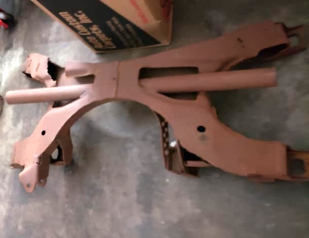

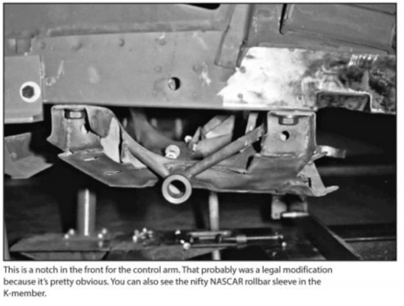

@AndyF built a splined sway bar for the Red Brick that went through the k-frame. Maybe he will share some wisdom on that.
Yep, that's basically the same design as the Kit Cars used. It used a tube with bushings at the ends and a splined shaft sway bar running through the bushings. These are pictures from the spring car catalog, and some of the ones used on the kit cars. I split up the catalog page so it would be large enough to read here, check out those torsion bar diameter and wheel rates on the second page. 1.38" and 654 lb/in !

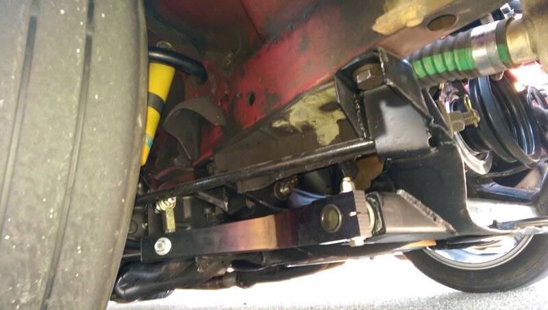

if you wanted to try a bigger hollow (chromoly) bar I could get my fab guy to bend one up and tigg tubing adapters for heims on the ends. That heim end set up is what has been on mine for 15 years. Just let me know the od and wall thickness.
pictured is 1" solid bar with tubing adapters / heim ends. this was done to accommodate the sway bar with my LCAs forward the extra 1".

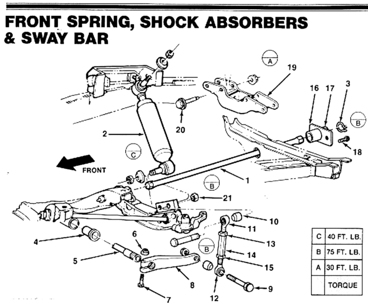

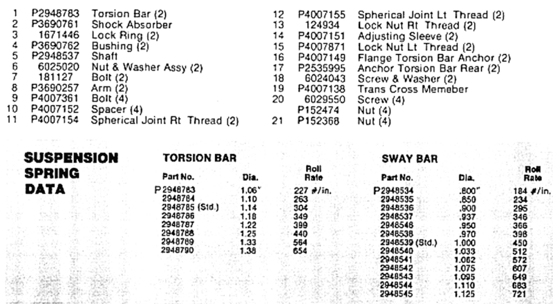

Here's one from one of the T/A or AAR cars, it was in a Mopar Action article. The sway bar tube runs right through the K and is braced. Also shows the notch in the frame where the factory cars have the frame stop for the LCA bump stop, not only is that gone but the notch allows even more suspension compression travel. On an A-body that notch would probably put the tire into the inner fender on full compression even with a stock LCA.

Some wild stuff right there. Also note the huge spacers to drop the K down. Along with the pointy end of the UCA bent down for what I assume would be a better ball joint angle with a really low ride height.

Yeah, they essentially did a body lift in relation to the suspension. I'm assuming for tire clearance?

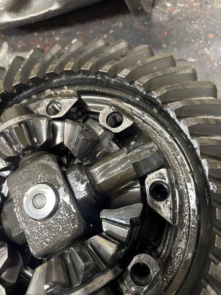

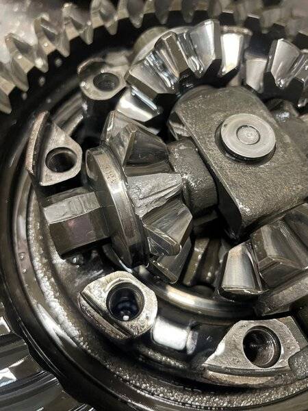

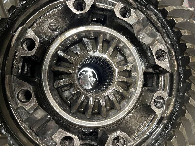

Learned something new over the weekend. I always thought my sure grip was the cone style so I never bothered taking the diff apart to inspect. I don't even know why I thought it was the cone type. I've had it forever! Well after trying out a new street recently opened near the house with a 1 mile straight, I'm happy to say the road is smooth, even at high speed. I give the road work guys and A+, hahaha. After 3 rips I noticed an odd sound coming from the rear end. Considering I was planning on autocross on Sunday, I figured it would be a good idea to inspect further. Well, it turns out it is a clutch type diff, and they are slap worn out. I'm assuming the spider gears didn't care for the additional clearance so they self destructed. Honestly, the diff is literally the only component on the car I've never inspected or rebuilt. I can't complain, it's my own ignorance/neglect. Also got lucky catching it before debris destroyed the ring and pinion. Tough year breaking stuff. First the lifter in the small block and now this. Let's hope that's it for a while.
Glad you caught it before it got worse.
