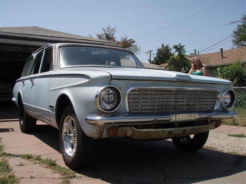

1963 Valiant V200 Wagon
well i got the fan mounted. i had to shove it over to one side so it would clear a supprt. its a pretty tight fit, but everything clears. i went with the biggest fan that would fit. even though its not centered, im sure it will cool better than my old 4 blade fan with no shroud.
well the wagon has been in need of floor pans, and i finally got around to installing them today. well at least getting them ready for installation. these pans are really nice. and they fit great. i will post more pictures as i get it done.
