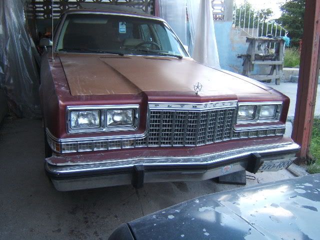

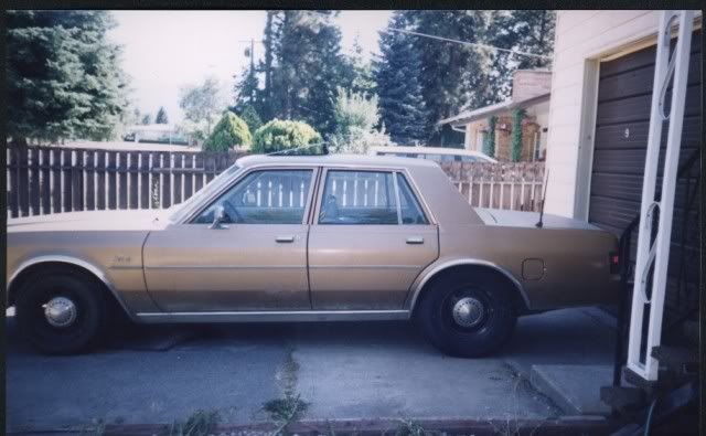

It's an 83 Plymouth Caravelle (Fury),ex detective car. Has all the usual heavy duty brakes,suspension,2:94 sure grip and a 318 4 bbl. Was my daily driver for 4 years. Im just getting it going for a trade deal. I'll get a big block 400/727 and whatever else I want/need from the donor car.
That will end up in my Dart. ThenI'll need to figure out what to do with all my small block stuff,lol! Sorry,no current pics of my Dart as it's buried in my garage.
I contemplated painting it and selling but theres not much market for bad gas mileage 4 doors,lol...but the gas mileage should pick up now. There was no less than 3 separate fuel leaks.So now it has a new gas tank and about 6 feet of new fuel line.
What it looked like when I bought it.

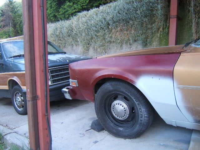

It got hit by a truck so I repaired it. Looks like this now.
245/60/15 all around mounted on 15x7 cop rims. Im keeping the rubber,rims and caps.
