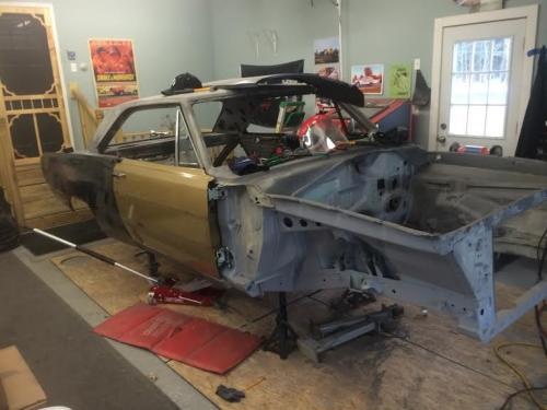

We started today..
The radiator support was made to go straight over the factory one but It looks better without it and it doesn't effect the stiffness at all... so we cut out the old one and fitted this one as a new support!
We also got one Inner fender brace completely on and one fitted and ready to go on..
Everything needs some finishing work but Overall It Looks amazing! Im so HAPPY!
Today we are working On getting Both the wheel wells out as well as the trunk floor and extensions!! It should be going to the body shop Next Weekend!!!
Today I worked on getting the right inner fender well all smoothed out and ready while my dad worked on cleaning up the drivers rear frame where the tub was.

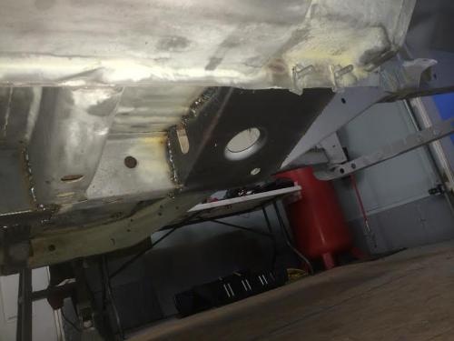

Yesterday I got My US car tool door hinge bolts in and my door hinges and strikers .. so today we decided to start smoothing the engine bay a little and also try to get the frame connectors and torque Boxes in.
We got one side done and welded in until we ran out of wire and were pooped to much to grind and finish .. Were getting there

Well it looks like it will be heading to the body shop this week or at the latest Saturday ... Got the frame connecters and torque boxes cleaned up and primed and then seam sealed. It is coming.. last things on the list are cutting off the drivers trunk/quarter extension and putting some more little touches on the engine bay... I DID finally get my new trunk pan in yesterday so.... its coming along
