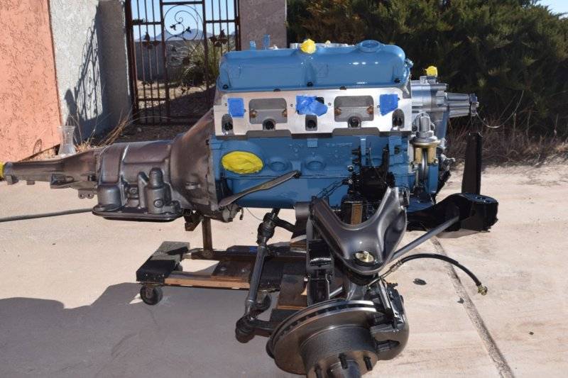

Mocked up the accessories to make sure we had everything and have the transmission fully installed. Tomorrow we will strip it back down and shoot the block/transmission with SPI Universal Clear then we will assemble for good!

Absolutely gorgeous day in Southern Arizona today.. The 318 powertrain is cleaned, touched up and cleared. Today in the sun and UV it will be set up hard by this evening and then it is reassembly time!

Some assembly required! Still need to finish blasting the manifolds and paint them Seymours Cast Blast.
Kaelyn put much of this together on her own...
