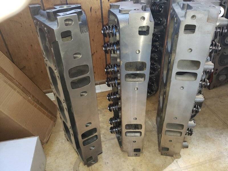

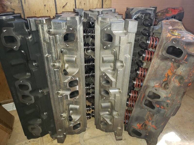

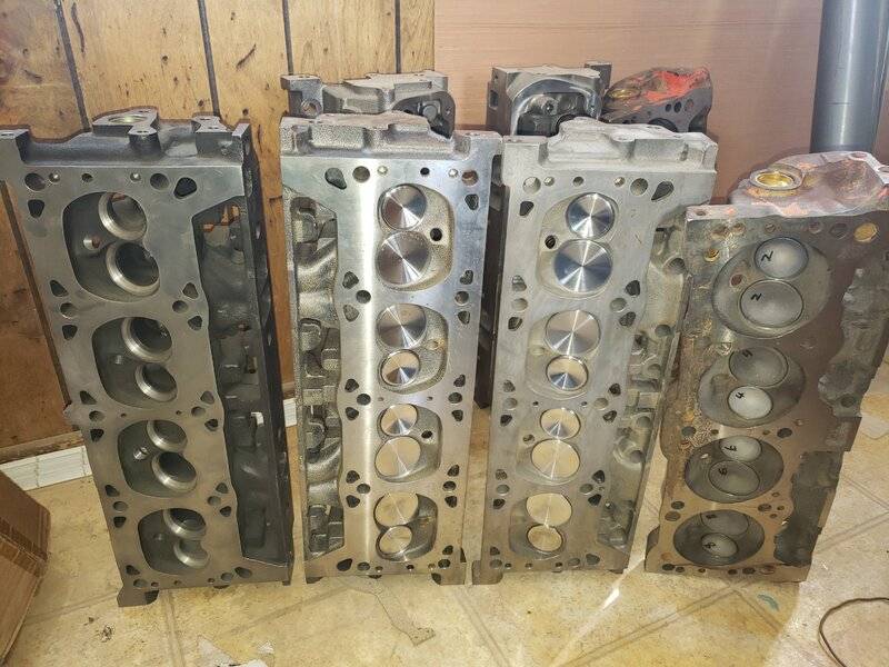

here....you guys look.....not on my list of things to do....lol
Left to right.....SM magnum...EQ done by IMM....Indy LA-X done by IMM...and..and TA head from AARCuda...
the SM head ports are alot rougher...
