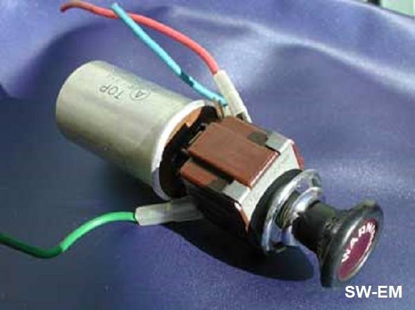

For hazard lights on that old girl you need something "special" or else conjur up a switch out of a 67--69 which is a separate toggle, mounts to the dash
HERE IS HOW the 67 hazards work.
You have turn signals and the switch and the turn flasher, just like your 64.
You have a hazard flasher (there are 2 flashers in the car) that flasher is always hot and feeds the hazard toggle WHICH IS a special switch
That switch has 4 terminals. When off, none of them are interconnected. When on, all of them are interconnected.
One pin hooks to flasher, one pin hooks to brake lights power feeding into the TS switch, and the remaining two splice into the left front and right front turn signal switches
Simple.......if you have that switch.

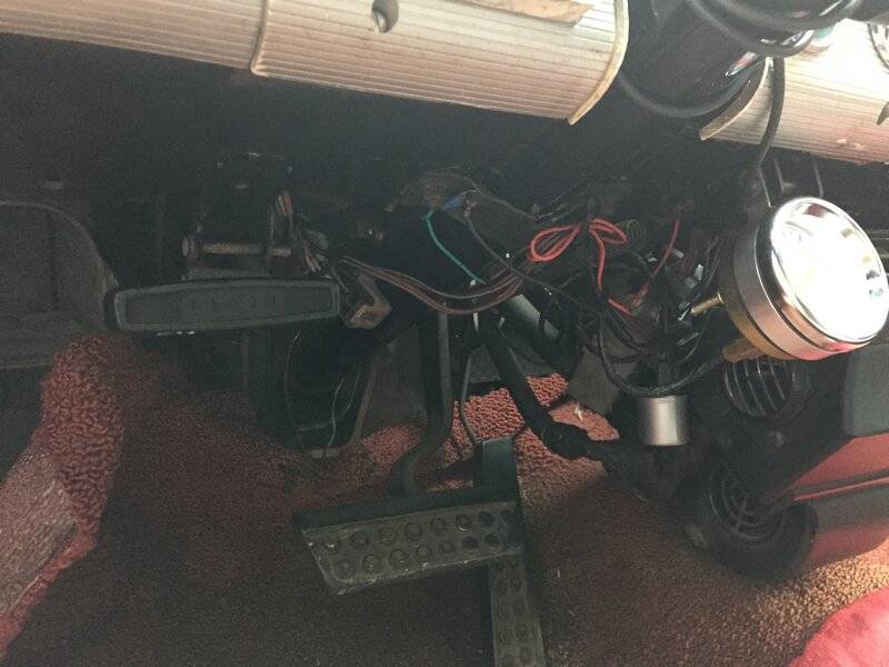

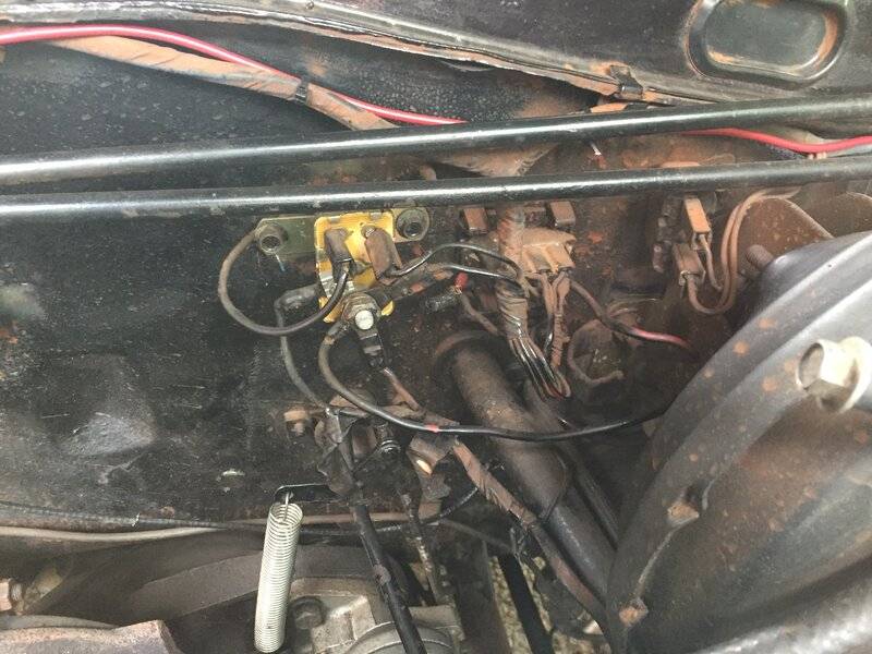

Below are some photos of the rat’s nest that Is my underdash

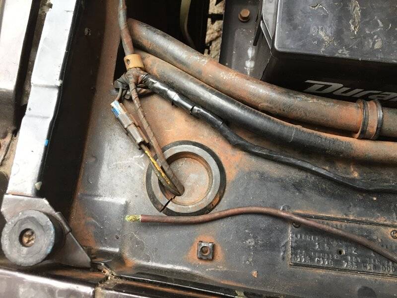

And the engine compartment

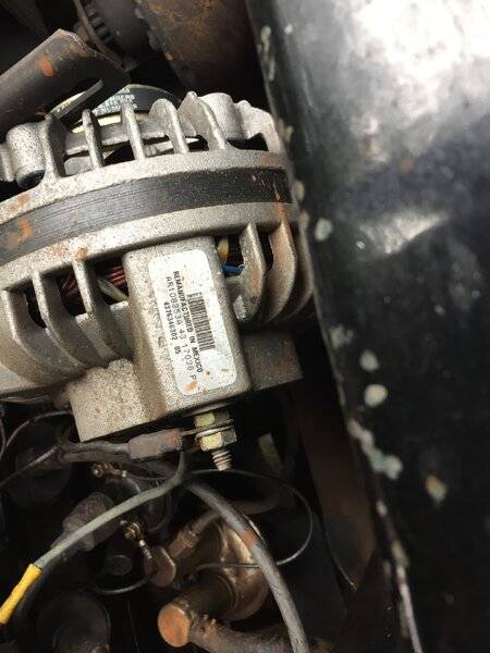

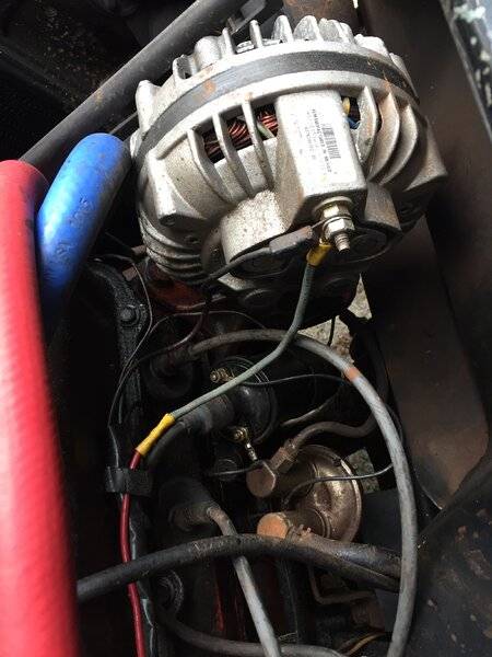

I know this is the fusible link for my alternator. Should I use their suggested NAPA voltage regulator or use the one already on the firewall? I can post a picture of their connector and harness for the alternator.

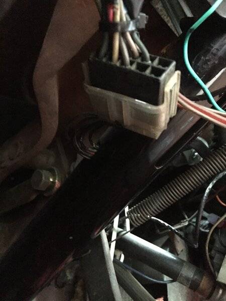

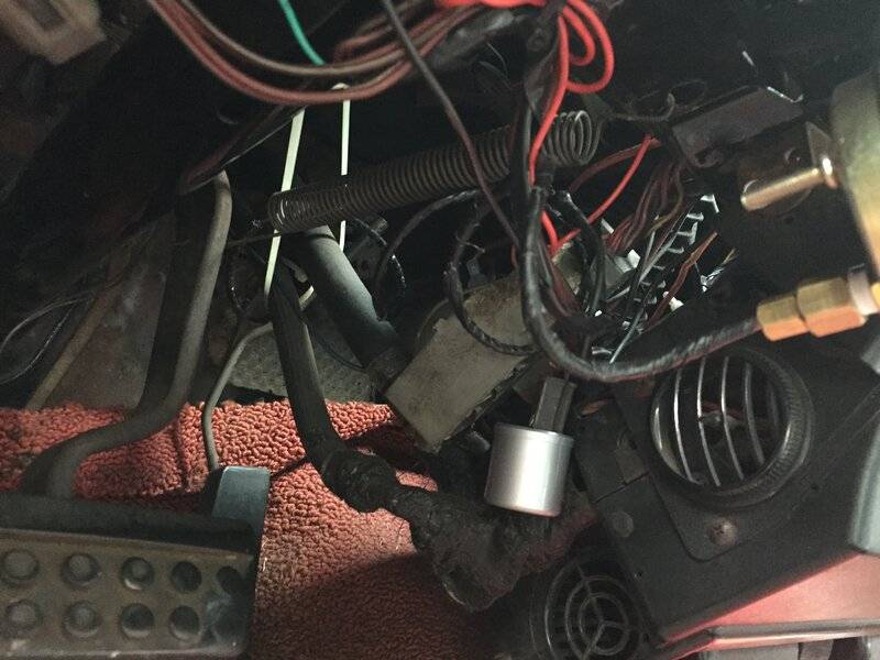

I believe the yellow piece on the left/center is the ignition and the connector on its right Is the bulkhead connector? That little bar behind the yellow is the ammeter? Only one wire so not sure stuff connected. And what’re the Two connectors all the way to the right?

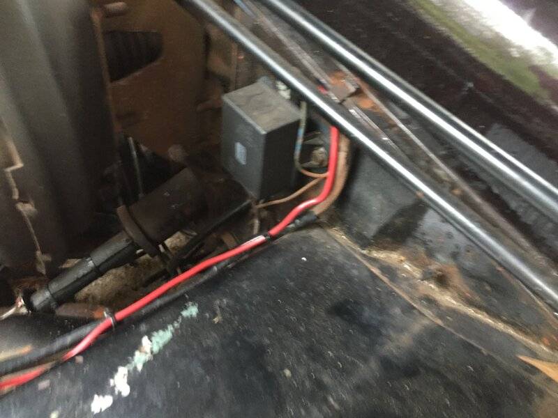

This is the voltage regulator, correct? Following the factory diagram I believe this is it.
These hoses run to the heater core, I’m honestly not sure I have the right size, since both don’t fit under the holder on the valve cover together. What’s that white bar on the top right with some wires?
Here’s the instructions and a picture of the the regulator wire and connector(s)
I see no reason to change the regulator if it's working now The Ron Francis one is actually a Ford one I believe, and it has a lot of circuitry in there you don't need (set up for warning light)
yeah the regulator works. I figured it was just them trying to standardize things. awesome, I'll connect those wires appropriately then. Saved me $40.
The Mopar regulators are the simplest on the planet. There are only two styles. The one you have, up through 69, uses one field terminal grounded. The 70 needs one more wire to work. It feeds power to one brush (must have isolated field or two insulated brushes) and one wire back to regulator plus VR power GM and Ford were never so simple. All he is doing there is using part of the hardware in the VR
Yeah looking at the alternator and the voltage regulator and the wiring I was provided I should be able to remove the connector and just run the appropriately labeled wire to the alternator from the VR. Shouldn't be a pretty easy deal. My main issue right now is coming from deciding where to mount the fuse panel. I think I'll remove and the driver's side fresh air duct and seal it off with sheet metal and a rubber gasket and then mount it under it. Just so damn big.
