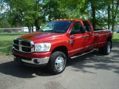

Probably something like this. Grocery-getter, in the walmart parking lot. The gal driving it was about 5' nothing" tall, and had to reach above her head to get to the door handle.
