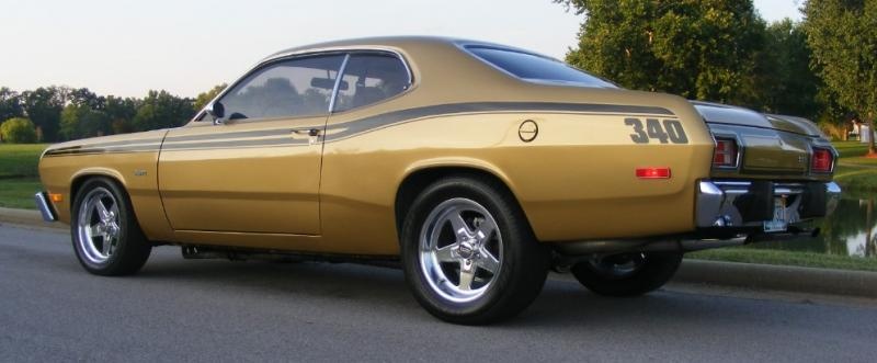

See this is why I haven't purchased the wheels and tires yet because Jimmyray runs 295s on his car no mini tub and springs in stock location and has clearance. The section width on the tire I want is 11.5 I believe and you are right, the wheel well is 12in and 12.5 if you roll the fender lip. I will have to just get a test wheel and tire before I purchase the set. OR I will purchase the set and if it fits GREAT, if not tub it, so that I am forced to tub it haha, but I will keep looking. My friend just told me his friend with a demon got a 325/50 to fit in his car WITHOUT spring relocation and mini tub, I said NO WAY, but he said he's getting pictures, so I HAVE TO see this haha
The problem with the Dusters/Demons is that the wheel arches in the back are pretty high. I've seen 295's on the backs of stock cars, but its because the wheels hang out past the quarters on cars with the back ends jacked up. There's no way a 325 will fit on anything resembling a stock car. That's maxed out for mini-tubs and a 3" relocation.
The only post on jimmyray's car I see he lists 275's, not 295's. And that's on a 17x8, which is borderline too small for even 275/50's, so it would squeeze the section width. His car also sits pretty high in the back...

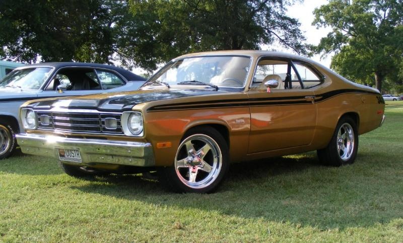

http://www.forabodiesonly.com/mopar/showthread.php?t=130381 post 12.. I messaged him and he said he has clearance. I also have pictures of guys running 15x10s and 295/50/15s. What I am trying to say is I see it, but I am not willing to do it myself until I have a conversation with someone who has done it or seen it for sure, so I am not arguing with anyone or anything. I am just trying to figure this out.
Here is Daniel Depetro running 15x10 4.5bs
http://www.forabodiesonly.com/mopar/showthread.php?t=30453
No worries.
Looking at both of those cars I'd say that those tires won't fit into the wheel wells if either of those cars were lowered the in the back. But that's just my opinion based on the pictures I've seen, I haven't seen either car in person.
If you're planning on lowering the car, and by that I mean having the tops of the tires higher than the rear wheel openings, then the biggest tires I'd run are 275's with the stock spring location, and 285's with 1/2" offset springs. Maybe that's a bit on the conservative side, but I don't think 295's will fit with the 1/2" offset. Not on my '74 Duster at any rate. Maybe you could get away with more on a drag only car, but I'm talking on a street car that sees speed bumps, potholes, steep driveways etc. But that's with a significantly lowered car. If the rear wheel openings stay above the tops of the tires, you can run just about anything.
