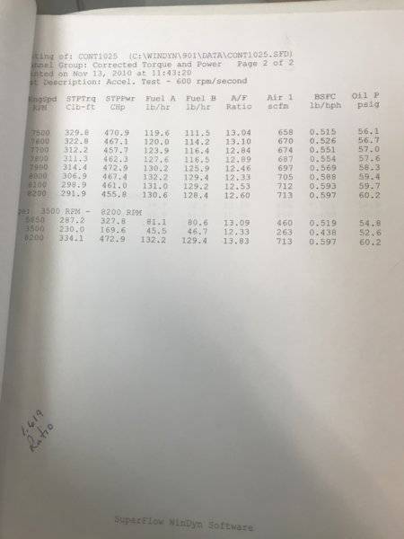

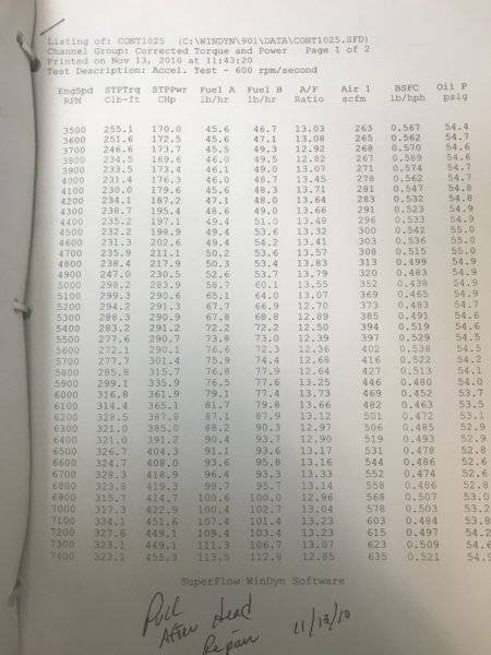

Anyone build a high RPM 273 using 2.02 size head?
I just built a 273 that will spin 8 but lightened my spring load and I keep the rev to 6 as the valve train was really tight and I was afraid that spring pressure was going to wipe out my mechanical cam.
Dyno was 355hp at 8 but with the new lighter springs it was 317hp at 6200rpm.
$10k to make that happen. Stock heads with some porting and stock sized valves. The larger valve will not help much because of the cylinder diameter is so small. Notching the block drops compression a tad.
I love my 273. But there is more HP for the same $ with the bigger CI motor.

I'd like to hear more about the 273 IQ52 built, I think it was 475 HP @7500 rpm.
"Stock 273 block 8 sleeves and 3.75 bore for 292 cubic inches
Stock crank
5.4 H-beam Ford rods with EDM pin oiling
Diamond custom pistons with crappy 1/16 ring package
Wet sump oil pan and HV pump with oil crossover
Iron magnum style engine quest heads w/roller rockers, jomar girdles and pushrod oiling
Comp solid roller cam and lifters
Lots better parts today to make way more power"

Let’s see if this works. I’m not sure of what pull this is. But it was one of the pulls at the machine shop- Larry’s machine in Groton Connecticut. Gary the owner is a good guy. Top notch crew. Most old school Mopar guys.
Seems I cannot get video to load. Let me see if my son tomorrow can upload to boobtube and then I can attach the link.
I think toolmanmike saw the video a few months back- maybe he can share it and if he has a copy.

It doesn't sound like something I'd build but I'm not knockin it. Maybe he wants something with peak power at 7500 plus. Some people like to rev things. Ain't everybody stroker lovers.
So basically, a uber expensive custom build, which makes less torque than a junkyard 360 magnum, and a soft soggy power curve that would be miserable on the street.
I feel a lot of people would be happy with 473hp out of a 360 with EQ's and a roller cam, don't forget it's torque to the ground not at the crank a 273 is gonna need about two full ratio's deeper than a similar 360. Only real kind of trick thing would be 8 sleeves which could do similar without. Yes a 360 or 408 would make a better street machine, I think this engine in a early A body heavily gutted road race street machine with four gear and some really deep rear gears like 5.13 plus would be a fun car. I bet most people building a built 273 would be happy with a 100-200 hp less.
As for the 2.02, most would have a hard time using up what 1.78 valve could do, If I was gonna do 273 probably would use a pocket ported replacement magnum head.

Everyone thinks I'm some kind of 273/318 hater, but that's simply not true. I have built numerous combinations of both, BUT the bottom line for MOST people is bang for the buck. So as a example, here is one I built back in 2017, and it has major restrictions. But for the sake of discussion, it is a .005 over 360, stock stroke, flat top piston, EQ heads very well prepared, but UNPORTED, with a 1.94 intake valve and a .420!!! Lift hydraulic flat tappet cam, a untouched performer 318/360 intake, with a holley 500 2 barrel carb. It cost my customer right at 6k at that time, parts, labor and dyno time. And unlike the 273 in the discussion which I think failed after a few pulls, this one is STILL running to this day.
