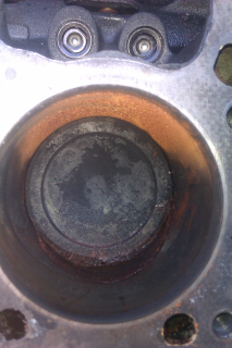

heres the pic i hope it works.
The rust doesn't look too bad to me. A .030/.040 should clean that up ok. Kinda weird it's only on the top side. But the lower side of the piston looks really funky like some serious detonation was going on? Might just be the pic though?
If you enlarge the picture you can see where water had pooled there.
I would definitely tear it down especially since you're going to have it in your pride and joy. No since in taking chances then have to take it back out.
If the idea is a temporary runner, I'd say pull that piston, hit the bore with some naval jelly, then use a quick ball hone on it and run it. The rust up where the rings need to seal is minor surface and I doubt it would create a big issue in a mild place-holder. Seen much worse pits in running engines tht ran pretty good. Not perfect.. but a possible temporary solution for you.
