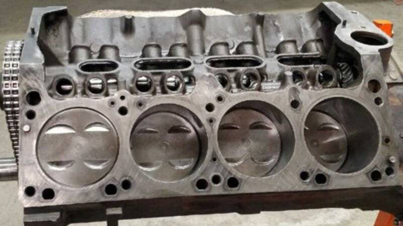

Stock 1969 318 Valve Relief Pistons in stock bore original 1969 block.
Pistons sit. 040 ths. down in the hole.
This engine was listed at 230 hp and 9.2:1 cr. with a dual plane 2 bbl intake and 2 bbl carb, before the re-ring job. Then upgraded to 302 closed chamber heads, 340 cam, LD4B Intake and 1650 Edelbrock 4 bbl carb and 2 1/2" TTI X-Pipe exhaust.
The 1969 318 original short block was sure a great place to start on our minor build up. Preforms Nicely . . .

Just suggesting because he had to go so much over. Jets posted a picture shping some original pistons like yours.
