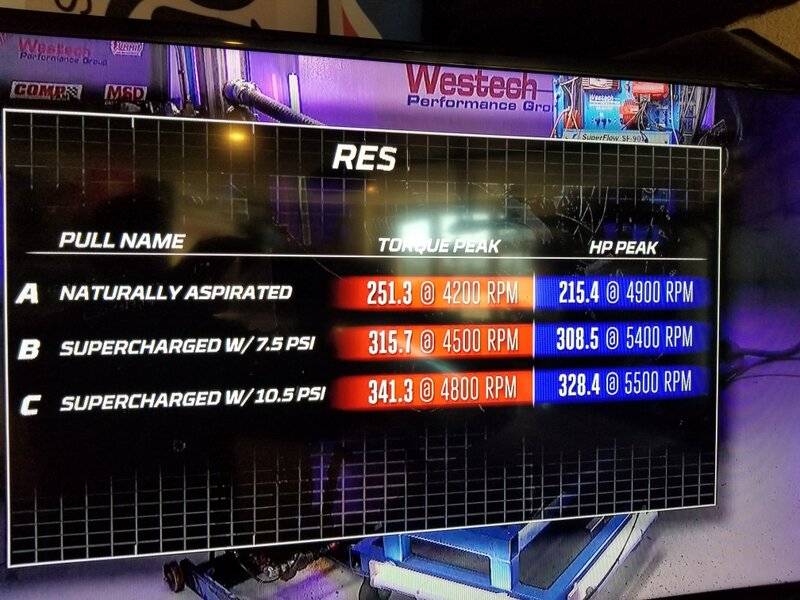

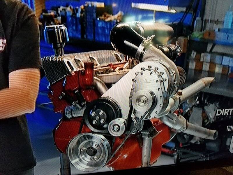

Steve built an, unknown size to me, 225 with flat top cast pistons, stock rods and stock cast crank.
Mild cam, Offy intake and clifford shorties were used from what I could see on TV.
The block was decked and the head shaved for 10 or 10.5 to one.
They used race fuel and around 30 degrees total on the first pulls, no blower.
Second pull was Torqstorm blower with a 750 Holley, 24 degrees total.
Third pull was a smaller pully on the blower.

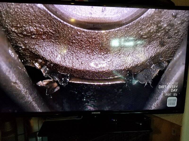

Head gasket blew out on number 5 cylinder on last pull.

340 power with more torque..sounds like a winner! Use a Cometic I guess......
They used some bullshitty cheapass head gasket and KNEW it when it went together. I just don't get it.
Yeah that gasket was either the Victor, like Justin said or it was the old Fel Pro Print O Seal, which are still around. I have a few. Certainly not good enough for 10.5 and 10 PSI. Maybe they wanted that as the weak spot and not something more expensive. Didn't it have cast pistons in it too?

I think they mentioned the goal was to see if they could make same HP as a 69 383 car, what 35 hp which they did with that $2800 air.
Steve mentioned he finished the build late one night with whatver had gasket was laying around. Typically in RoadKill half assed fashion.
Given that they used cast pistons on a boosted build, maybe the intent was a bolt on supercharger in a typical street slant?

I think maybe @Charrlie_S got it right. I think maybe it was meant to be an N/A build from the rip and somehow a blower fell in their laps. I see no other explanation for cast pistons on a blown motor runnin 10psi. I mean THREE THOUSAND for a blower but wouldn't spend SIX HUNDRED on pistons? that tells me the blower was an afterthought. Even so, it's still cool.
