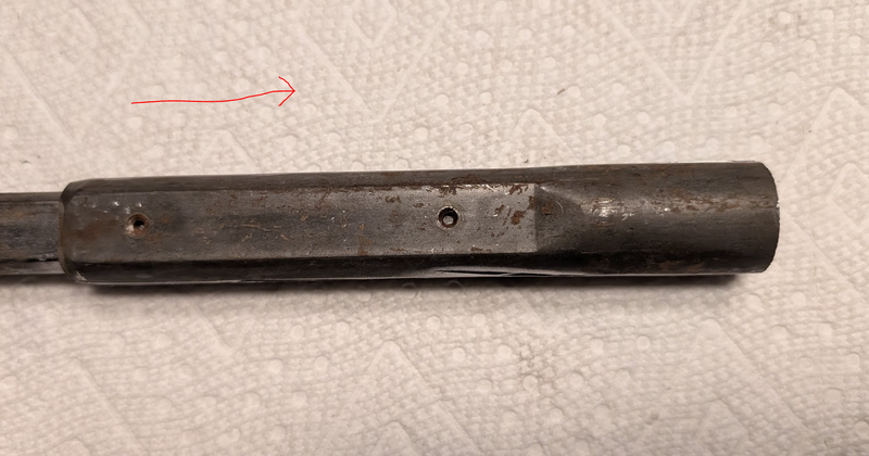

The red arrow points to the missing bit of plastic. The first indication Charliec had that something was wrong.
The green arrow points to a bit of plastic that was still in place BUT was no longer attached to where it was supposed to be.
The other side also looked fine BUT they were not!

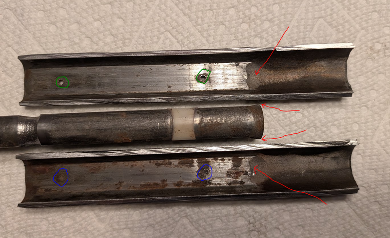

So to get the outer piece of shaft off I decided to cut it lengthwise on both sides
The green circles show where the plastics bits fell out of the outer shaft
The blue circles show where the plastic bit retained in the outer shaft
The Red arrows show where the inner shaft is smooshed to make it wider and where the outer shaft is crushed down to make it narrower preventing the inner and outer shaft from getting longer buy more then an inch or so. BUT nothing stops it from getting shorter, and remember shorter is bad!
Here you can see the injected plastic that would normally keep the two shafts aligned.
The red arrows point to where the plastic that is visible on the outside of the outer shaft was attached at one time.

So my conclusion is without drilling a small hole through plastic on the inner shaft there is no practical way to re-anchor the two shafts together.
If you just put adhesive or melt plastic into the hole the contact would only be flat surface to flat surface. Very little effort would be needed to shear that chemically bonded joint. Now if you drilled a hole into the plastic and filled it with adhesive or plastics the joint would have an actual shear joint.
I would be VERY tempted to drill through one and stick a BRASS 6 or 8-32 screw and lock nut in there
There is more than enough metal to drill out the small hole and tap it. Then put a set screw in.
With a dimple in the inner shaft it would lock things together well.

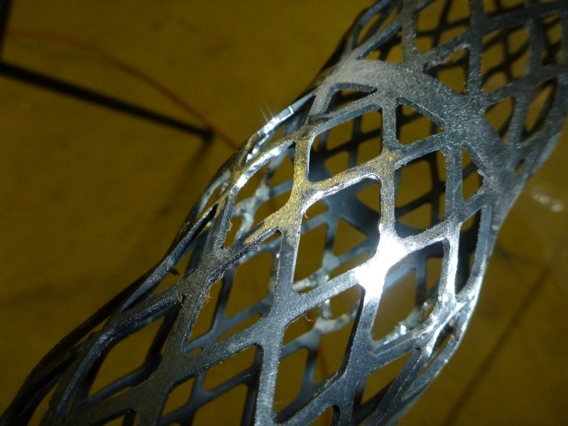

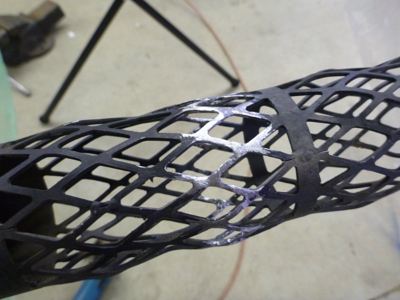

Pins and the mesh column section are there to collapse when you hit the wheel. Why the column is mounted on slider blocks are not solidly fixed. Just ask my Dad... when he ditched the Bee back when I was a kid... LOL I had to fix that mess when restoring my Bee, but we never even noticed it mind you for 40+ years until I tore the car apart. Plastic sheared, outer column collapsed and broken.
