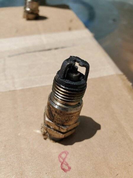

I am trying to determine if it was outside temp, engine temp, combination of temps, lean mix, etc. If his car ran so much cooler than mine, like Yellow Rose commented on, maybe it is a big factor in the equation. It was a gear change, cruise rpm change, highest ambient temp ever driven, and furthest I have ever driven it.
I pulled the plugs. They don't look good but not as lean as originally looked. There is oil burn present also.[/QUOTE]
Spark Plug pics...
Ouch!
There is so much oil burned onto them I really cant tell what the hell is going on. At this point I would have more concern where all the oil is coming from?

Ok, you have to lose those plugs. That giant assed ground wire hanging out there getting red hot isn’t helping anything.
In fact, that plug is not only the wrong brand, it’s the wrong design. IIRC a 452 head takes a J series Champion which is a 5/8 reach, 13/16 hex gasket plug, not a tapered seat like that.
It could be later BB heads went to that tapered seat plug but I don’t remember that.
I’m not saying anything else until you get the right plug in it and go beat on it a bit.
But I will say this. If I had to just look at those plugs I’d say they are too damn hot, you are far from lean anywhere and you have an oil control issue.
It’s hard to fix a tune up when the plugs are that wrong.
What is the "it"? The hesitation and/or the surge? I think we know that is most likely due to the increased load on the engine.
If the gears hadn't been changed coolant may have run a little hotter strictly due to the length of time running on a hot day, but none of the drivability issues would have shown up. Did the gear change also increase the heat load? Possibly, if the engine is working harder.
However, now seeing those plugs, that could cause some drivabilty issues right there. I don't know if its just oil, or oil plus kernel growth and flame front being disrupted. Look at number 6 and the one location on the end of the shell thats pretty clean is where there electrodes don't shadow.
