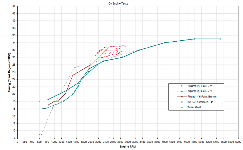

Below is a graph of the timing where it pinged with red highlighting the problem rpms.
It shown in relation to the timing that it now has with a different distributor.

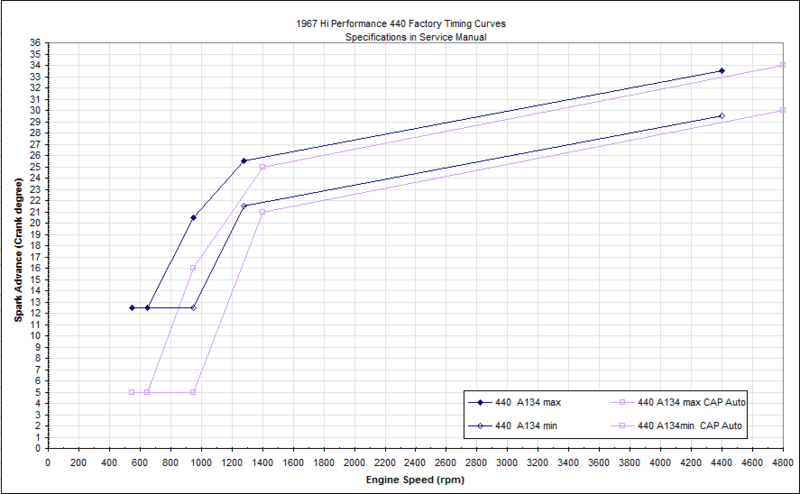

The factory always had the timing continue advancing well above typical cruising rpm.
Max and min here are refernces to the advance curves. Base timing could be set higher or lower as fuel and altitude permitted. That would shift the timing curve up or down.

He provides a stage by stage explanation of the combustion in this thread about dynoing a 440.
Motorsports Village • View topic - Dyno time
Finally, here's a case (non-mopar) where he warns that cruise timing and AFR could cause problems when going to full throttle. But I don't think 71GSSDemon's engine is in this situation but maybe worth keeping in mind.
"Your engine has a big cam for that low a compression so I'm not going to get into helping you tune it. My advise is to be careful about the tuning because if you go the wrong way you will end up making NOx at light loads and damage the engine when you stomp on it. If you run it rich it will be safe and the reading on a WB cannot always be trusted. If you used a gas bench and a dyno you will find that engine has plenty of unused Oxygen in the exhaust and thats a bad thing, it means there is unused hot Oxygen's left in the cylinder and thats dangerous,thats why you need to be rich and no where close to stoich. Pick the wrong ign timing at cruise and you will have hot carbons glowing waiting for you to open the throttle and give you some preignition woes. So id put up with a rich cruise, maybe not as rich as you describe but more in the 12.5 12.9 range. I wouldnt advise to go leaner than that unless gas bench and dyno confirmation showed otherwise."
http://motorsportsvillage.com/forum/viewtopic.php?f=6&t=915
Wow that pretty much follows some of my thoughts on "cruz tuning".
My ways I am sure are nowhere near as complex but I think I may be on the same path.
Great stuff, keep posting
