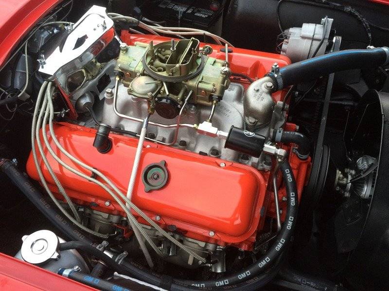

1965 Cheverolet L-78 with 4150 list 3124
This appears to be an original 4150 Holley List 2818
As shown in this diagram
