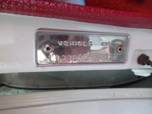

The body is an LP23 as stated on the fender tag. All 1966 Dart GT's were L=Dart P=Premium 23=Hardtop.
The LO23 on the VIN tag is because of the "Dart Drag Package".
The fact that the D/Darts were regular production line automobiles may account for the LO LP discrepancy. There are no trick body panels or trim differences to differentiate a D/Dart from a 273-4v Dart GT. I'm suspicious of the white car VIN plate. Uneven spacing and line not straight.
LO 23 D 6 2 653932
LO - Dart Superstock
23 - 2 dr hardtop
D - 273 CID V-8 (all 2v & 4v had this designation in 1966)
6 - 1966 model year
2 - Hamtramck Assembly Plant
The last six numbers are the assembly plant sequence number. Each plant started with 100001 regardless of the car line. EXCEPT HAMTRAMCK built Valiant and Dart models which begin at 500001. (emphasis mine)
(source Chrysler Corporation Production Production Option Code Book 1966 - 1968, Fourth Printing, Jan. 1996. page 1. Galen Govier ed.)
Not all Darts and Valiants were assembled at Hamtramck. The sequence number would put this D/Dart car pretty deep into the production run. That would put this car well into 1966 limiting a team's ability to tweak on it before putting it on the track.
The door tag denotes that the car is one of the 50 cars produced as a Dart Drag Package.
Fender tag shows the car as it was when it started out in life.
