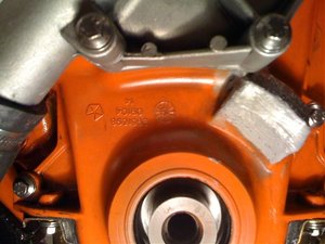

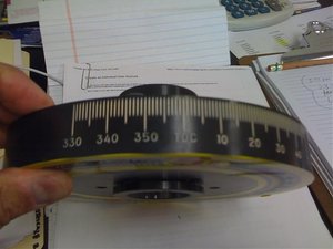

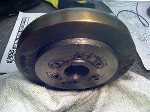

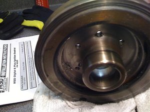

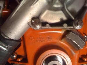

Here is a few pictures of the balancer and the damage on the cover. I will probably mix up some JB Weld and just patch it and repaint it! Dont want to get into the front cover if I dont have to.

When it wore through the cover, where did the shavings go?
You might want to pull the pan to make sure it's clean, along with the oil pump.

I checked the oil and there are no METALIC looking shavings in it when held up to a light. I know it leaked alot of oil when this happened I am thinking that this forced most of the pieces outward by evidence of shavings on the k frame along with being on the back of the damper. It had oil pressure when I shut it off also. I will Flush the pan best I can before I run it and then change the oil a few times before I take it out.

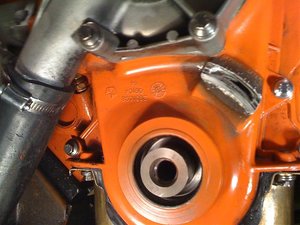

The Patch...........JB Weld Stick. This stuff works awesome!! Dont like using it but in this situation I dont mind. I used some Gray Silicone over the patch for any pin holes. I did not see any but just in case.

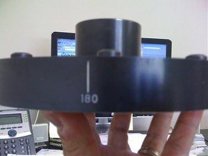

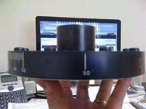

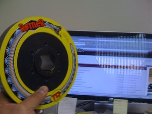

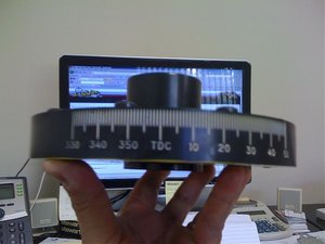

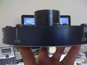

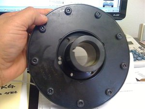

It has arrived. I have found no good pictures of this Damper online so I decided to post them so you all could see its construction. I really like how the timing marks are on the correct side of the damper.
Is there a reason they call it "The Rattler"? Marketing hype? I always wondered if there was some sort of moving counterweight in them or something that made them noisy. It really looks nice.
Marketing hype. You always gotta have a catchy name you know.
Hmm, the rattler doesnt sound like a good catchy name though!
