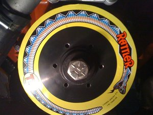

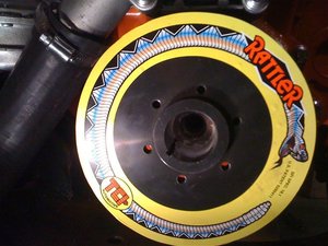

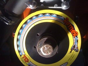

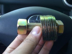

Says you need a tool, I can see why the bolt is WAY short that holds the damper on. So I went to ace hardware and was looking for a STUD full thread to screw into the crank and back off about 1/2 inch and use a nut and washer to pull it on. They didnt have one so I used this set up instead. Worked Great. I also got a nut and used that to chase the bolt threads before I put it in the crank. The threads had some marks on both the TOOL I rigged up and the REAL Bolt this cleaned them up well.
I used a few washers then tightened the bolt down, backed it out added more washers again and again until it was all the way. I used a NEW BOLT and Washer for final assembly and then torqued it down. I will finish the install tomorrow and fire it back off then adjust the valves. I am also flushing the pan a few times with some cheap oil just in case before filling it up with Brad Penn " THE GREEN OIL " Reminds me of Kendall when I was a kid. Anyway here are some pictures.

Thats cool maddart! I have the same (tci rattler) on my 408. good luck with that badass engine! be easy on it!! lol. cant wait to run the piss out of mine, its still on the stand sitting in my room...

Mad, check the bolt alignment of your pulley with the balancer. Sometimes those are drilled for chevy pulley bolt spacing regardless of car they are going on. You might have to drill one of the holes in your pulley, or slot it, to fit.
Rob,
Yes that was already done for the last damper but this one actually lined up perfect. I had to file on the washers in 1 spot on all 6 so they would clear the dampers hub. The Pullys did not need to be messed with like I originally thought everything lined up Perfect!!
Also FYI I did not touch the distributor at ALL and when I checked the timing again it was 5* RETARDED........... I am sure that the DAMPER slipped on the DYNO because I set it exactly how Brian had it when I installed it in the car.......now without touching the Distributor it is off 5*??????? ALSO the timing marks are dead on NO MOVING AT ALL with the OLD Damper it would bounce 2-3* not anymore!!!!!!!!!! Andddd the temp stayed at 165-175* nowhere near the 200* that it use to touch.
The engine sounds VERY healthy with the timing where it supposed to be.
IFFFFFFFF it slipped on the DYNO then wouldnt it create more HP and TQ because the timing was Retarded??
