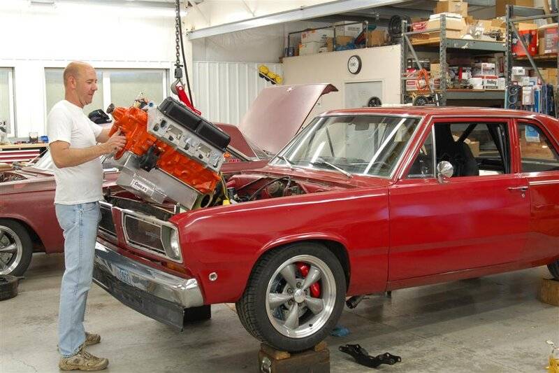

When I was helping Tim with his red Valiant we looked at all of the coil over kits on the market. That was a few years ago so things have changed a bit. But back then we came to the conclusion that the only benefit was the better steering. The FMJ knuckle was a good height, was very sturdy and we had good brake options. The coil overs were more adjustable, but that wasn't really a big concern. The M2 knuckle was short and not very robust. We ended up staying with the torsion bar design although everything was modified. We eventually ended up building a lot of parts ourselves just to get the packaging correct.
If I was doing it again today I might come to a different conclusion. It really comes down to budget and what the desired results are. For a competitive car I'd build a twin a arm suspension. For a street car I'd stay with stock stuff. For a serious drag race car I would go with struts.

No, we didn't care about the theory. We just lowered the car until we ran out of room and that was that. Suspension travel was the biggest issue on the car. What we needed was a dropped front spindle but nobody made a good one. There was a piece of junk on the market back then, but after we looked at it we decided to just stay with the FMJ knuckle. I thought about building my own knuckle but eventually decided not to.
