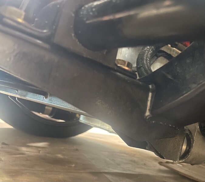

Regardint the sway bar, there is never a perfect side load, it's always a tension load up/down on those points so it's unlikely it slides at all. But there is a load with an angle and that design will be under bending and torsion as a result of it being unsupported. It just seems like they would be flexing all over the place. The design in the Alter-K is different and IMO better in this area.
I was trying to prevent this thread to get back to the strength debate, but I'll address this and I'm done.
@goldduster318 I can appreciate the deep investigations from your engineering mind. I'm an EE and can get down in the weeds on many topics as it pertains to electric power generation.
What would you say an average torsional spring rate is on a 1" solid sway bar? 250lbs? If so, 250lbs won't be applied to only one tab, it will be a shared load on both of them. Likely one side being pulled up and the other side being pulled down. Would it be even on each, I don't know.
The tabs are 5" long and the center of the bar is 2.25" from the crossover square tubing. From what you are saying, a 225lb load applied 2.25" from a welded corner of a U shaped bracket will bend it. I'm not a mechanical engineer, but I'm saying that $hit ain't going anywhere. So here's what I did. I put a magnetic base dial indicator on the bottom of the lower radiator square tubing (old school XV piece). The indicator was on the end of the sway bar tab. Then, using a wooden block on the sway bar itself, I jacked up the car up using the sway bar to lift the weight of the car. The block was about 4" away from the sway bar tab. I lifted the car 2.5" from its static height and the end of the tab deflected .025". I continued to lift the tire off the ground and deflection increased to .045". The indicator returned to zero when I removed the jack. My car weighs 3500lbs. I have no idea what one corner weighs, but I bet its way more than 250lbs, or even 125lbs if the loads are divided equally on the mounts. Heck, just lifting the corner 2.5" was likely way over 250lbs. Also remember I was measuring 2.75" further away than center of the bar, so likely less deflection directly under the bar. What does this prove, heck if I know, but it certainly isn't a wet noodle as some have said. FWIW, I also tried with the mag base on the bottom of the K and that resulted in only .010" at 2.5" of suspension lift. However I chose another spot to eliminate comments about the K moving with the sway bar tab. I'm sure this will que the comments about the frame twisting now since the deflection was greater when the mag base was on the lower rad support. My response to that is, it's a 50 year old car picking up one corner. I'd like to see another one that doesn't move .015"!
Next, I'll comment on the paralleling discussion. I get it, there's no triangulation, but you aren't going to see that K riding down the road without a car attached to it. Once it's bolted in, it essentially has two 16' long frame rails with a whole bunch of structure holding it square.
Do you ever sit in a bucket seat on the floor and wonder why it falls backwards? That doesn't mean its a shitty design, it just isn't being used as intended.
Lastly, reference your markup below. That rectangle plate holding the LCA tube is triangulated. There's piece on each side with the endplates as seen. The force would have to overcome the triangulation and the brackets which are designed in such a way that they slide on to the end of the tube for construction, they aren't simply butt welded, they are keyed to the square tubing. Then it would have to twist the mounting bracket that is made the same way. And lastly, the cross bar would be pushing on the other side that is obviously the same construction.
FYI. This is the current sway bar mount design, not like the one in the pictures above.

Thanks for making the effort to test it in this way.
Because that design turns it more into a cantilever beam and assuming the force at the center of the bar is the same in all cases, simply moving it closer to the tube by mounting the bushing vertically as seen in the RMS Alter-K-Tion is an improvement (though the sway bar is very low hanging otherwise), it's just flat out deflecting less. Let's say that with weight transfer included the car might have 800 lbs by jacking up one corner in a static condition.
The issue with the parallelagraming is -> that is the most weak direction of the car and where its quite relevant for cornering, if, for example, there was no k-frame, the car in front of the windshield is kind of like a cardboard box with the top and the bottom removed. It would parallelagram or even splay very easily. The K-frame of any type helps resist it, and the k-shape would be harder to twist with a load applied at the LCA pivot point than having a simple crossmember at a right angle. The more the load is behind the rear most bolt, more lever arm, meaning more flex each time. The stock one the arm is behind in the same way, but the pins are directly behind the rear bolts for the k-frame. It's actively reducing the twisting directly into both the k-frame and the chassis without any cantilever lever arm. This is where adding something behind comes in because it would generally stop any of this twisting action relative to the body and spread out the load. You can see this with something like the MM mustang K-member. It's not possible with the OE type oil pans and the available headers to have the crossmember go directly through the LCAs which would be an alternate design.
I don't know the reason for the cross bar having a rod end. The left to right side can twist meaning if, for example, you went into a corner and the left side mount is attempting to move in an arc due to the twisting of the k-frame about the axis going front-rear in the car Since there is a ball there, it just keeps the straight line distance to the other side the same only in the cross car direction, it will do zero for any simultaneous front-back movement because it will just pivot on the rod end instead of having to bend the rod to deflect. With only one bolt on each side, it can also run an arc. The degrees of freedom are not adequately restricted to get the best possible effect. For example, my truck has a removable crossmember similar to the transmission crossmember on our cars in roughly the same area and it has two bolts on each side with what's essentially a box tube in the middle. It has no degrees of freedom other than literally twisting the steel.

The tabs are 5" long and the center of the bar is 2.25" from the crossover square tubing. From what you are saying, a 225lb load applied 2.25" from a welded corner of a U shaped bracket will bend it. It will and it will also distort the square tubing it is attached to I'm not a mechanical engineer, but I'm saying that $hit ain't going anywhere. Nobody has made that claim it is "going anywhere" So here's what I did. I put a magnetic base dial indicator on the bottom of the lower radiator square tubing (old school XV piece). The indicator was on the end of the sway bar tab. Then, using a wooden block on the sway bar itself, I jacked up the car up using the sway bar to lift the weight of the car. The block was about 4" away from the sway bar tab. I lifted the car 2.5" from its static height and the end of the tab deflected .025". I continued to lift the tire off the ground and deflection increased to .045". The indicator returned to zero when I removed the jack. My car weighs 3500lbs. I have no idea what one corner weighs, but I bet its way more than 250lbs, or even 125lbs if the loads are divided equally on the mounts. Sorry the loads are equal and opposite Heck, just lifting the corner 2.5" was likely way over 250lbs. Also remember I was measuring 2.75" further away than center of the bar, so likely less deflection directly under the bar. And this should prove that the RMS SB mount location is a stiffer design by simply being half the distance from the square tube crossmember and also allowing a shorter arm for the SB with a smaller diameter needed for same SB wheel rate What does this prove, heck if I know, but it certainly isn't a wet noodle as some have said. Who said that? FWIW, I also tried with the mag base on the bottom of the K and that resulted in only .010" at 2.5" of suspension lift. However I chose another spot to eliminate comments about the K moving with the sway bar tab. I'm sure this will que the comments about the frame twisting now since the deflection was greater when the mag base was on the lower rad support. My response to that is, it's a 50 year old car picking up one corner. I'd like to see another one that doesn't move .015"! It you find this acceptable, I am then puzzled why so many here are constantly obsessed with LCA welded gussets, 11/16" TR, using subframe connectors AND torque boxes together, etc without any knowing numbers? This exercise here would have been most useful in the big picture had the same measurements had been made with an OEM sway bar set-up, and I fully admit you were under no obligation whatsoever to do so. The only explanation I can find to my puzzlement above always seems to circle back to the age old "confirmation Bias" predicament, and that will rankle some, but I have heard that before.
I believe it is very basic. And a restriction beyond one degree of freedom at this location, given the "real estate" available, and that the likely loads that would soon lead to failure likely due to fatigue with more joint restrictions. while proving that there is loading here and its significant. But you can't include a solution that you know will fail, so you don't tackle the problem until you can. Yes the spherical joint connection is only an improvement, but certainly not a cure all.
I've seen many Monte Carlo bars with spherical ends strangely.
