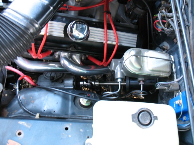

how is the name at this coupler on pic ?
attachment.php
PapstXX, from post #41 of this thread:
"I went to the Flaming River web site to link the shaft and coupling but it looks like they have dropped it from their product line. The part number was 1505M. Back in March '07 when I ordered mine the kit went for 109.95 thru Summit. Flaming River only shows two part numbers for Mopar couplings and they start at 1506M. That's a shame because it was such a simple and effective solution for the early A header/steering interference. Damn them!"
They still offer some couplers but have dropped the "D" shaft with the cup on the end that you weld the steering shaft into. It's the shaft that gives you the needed clearance to the header/manifold.
