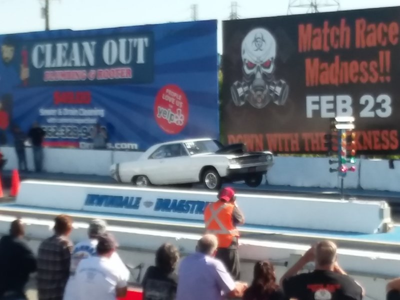

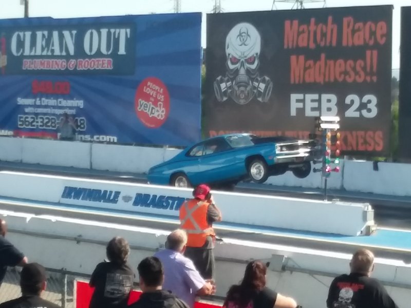

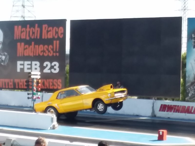

That ben almedas car in the middle? (or at least the one he tunes...)
He builds the engines and tunes. 900hp n/a small block Ford. Not Ben's car.
All three of those cars are N/A 10.5 tire cars.
Yeah, i watch bens videos...the guy hands out some great information
I wondered how you knew that car! Latino guy own/drives it, can't remember his name right now. (Tunnel ram, Cleveland style heads, 450+ inches, I'm told).

Yeah, most of his videos have that car in them at some point :) I have learned a ton from him
P.S. sorry OP.. back on track now
Erwin (Irwindale) Cuellar in the yeller stang. And an older picture of Shilohs Dart as he’s got that thing scientifically advanced enough to where it hardly pulls a wheel. Lastly a guy that brought a spork to a gunfight
