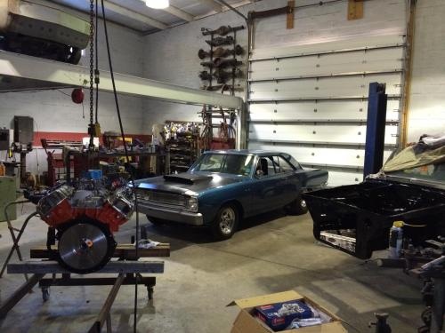

Pic of Bruce's Dart and my motor in his shop. He has a very nice Dart, 383 auto, runs pretty good.
Great pic for any Hot Rodder to enjoy!
