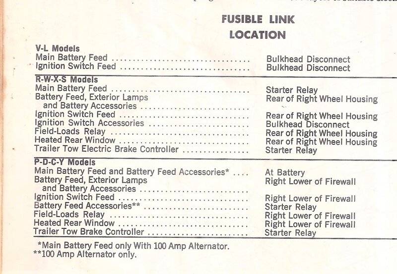

Also look for and check other fuse links. These always have an obvious bulge "for no reason" and or a molded tag hanging out to the side.

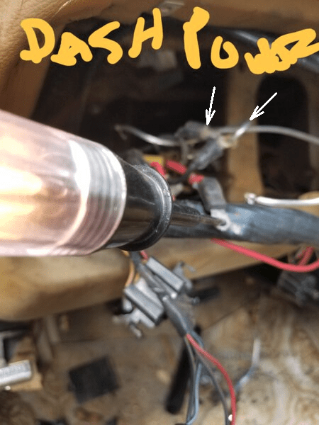

Ya thought of seatbelt but attached pics. No power to fuse block power to dash panel, power comung in from bulkhead only in 1 spot thats shown from outside fuse link too. And not sure what the cylindrical relay is there i put a pic of as well. Just perplexed

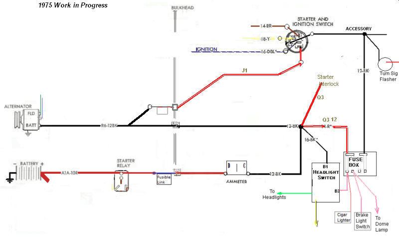

Lets step back to look at the basic wiring concept.
There's a welded splice which joined the alternator and the battery with the main feeds to the key switch, lights, fusebox hot, and sometimes horn. Regardless of where power came from, battery or alternator, it went where needed from the main splice.
The fuse box has 2 - 3 fuses that get power only when the key is on, and 2-3 that are always hot.
Above I wrote "a welded splice which joined" in past tense. That's because '75 is a little different.
Also if the car had rear window defrost its again a little different.

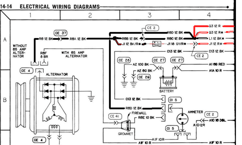

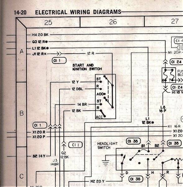

Lets look at the '75 wiring diagram. You can then convert it or redraw into layout showing just what you are interested in. That's basically what I did above with the '72.
Here's a section of the '75. As I mentioned above, power distribution is a little changed from earlier cars.
Notice on the alternator's output wire (R6) there is a J1 wire spliced in. 12 is 12 gage
J1 typically designates a feed to the key switch. This arrangement is different from earlier wiring.
CE2 is the bulkhead multi-connector. There's a seperate drawing or list indicating which cavity.
But we can see the grsay& red fusible link should plug into one of those cavities.
In the diagram you can see the firewall grommet that we've seen cars that have had the rear defrost and 65 amp alternator wiring.
Once your sure the car does not have the 65 amp wiring option, simply ignore or erase those lines. It makes the drawings easier to read.
C13 12 black is the feed wire to rear window defrost. So we can do that right now.

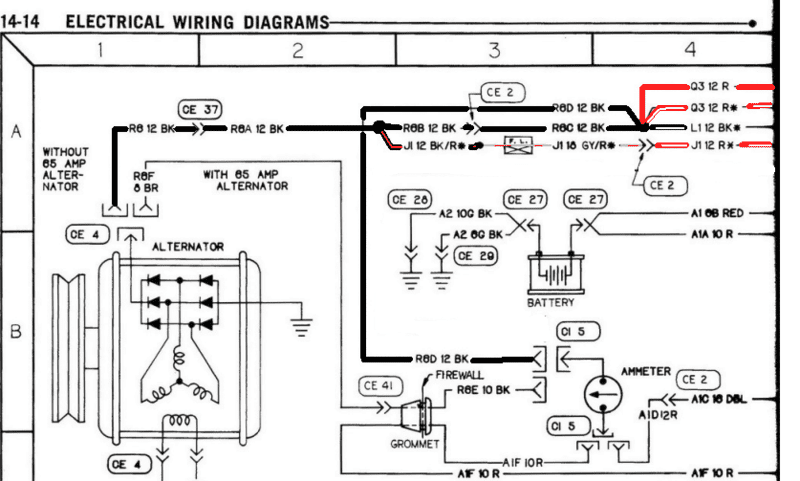

So here's that information used to alter the schematic
So now we can see how its possible to have power at the ammeter and the fusebox, but not at the key switch.
12 gage Red with white trace is Q3 feeding the two fuses on the accessory side of the fuse box.
Black 12 gage wire is hot only when the key is turned to run or accessory.
