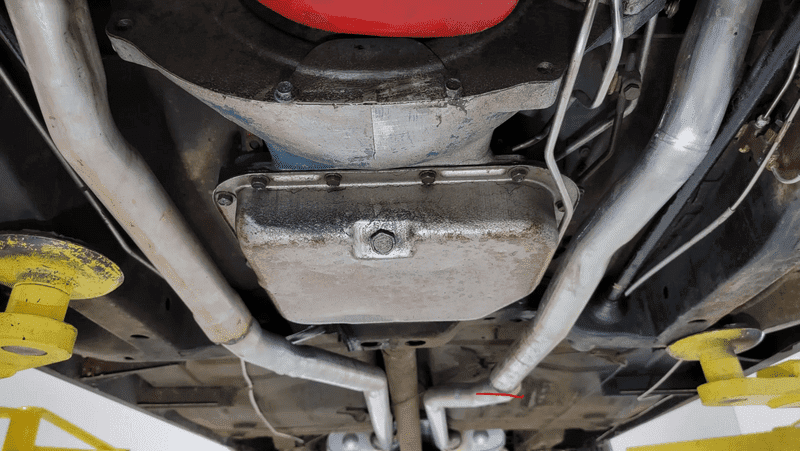

Still planning out my build and came across pics from an old BaT listing. This car has a dual exhaust where it looks like they just flattened the pipe a bit to get around the trans crossmember rather than modding it. IF others have gotten away with this I'll probably do the same since I dont really plan on lowering the car at all.
Looking at that exhaust, you'd be better off with a stock HP single system. Without a good crossover, it won't scavenge very well. I like the X ones best if you keep the duals. Looks like you're missing the engine to transmission braces too. I recommend you find a pair and install them.

BTW, that pic looks like the crossmember WAS modded- he just didn't route the pipes to take advantage of it.
i agree, from the pic it looks like it has already had the modification done.
I think yall might be right. What's so hilarious is, the driver's side pipe wasn't even bent to take advantage of the stock exhaust cutout in the cross member and hangs down lower then the passenger's side. lol
close... but not quite! lolz
