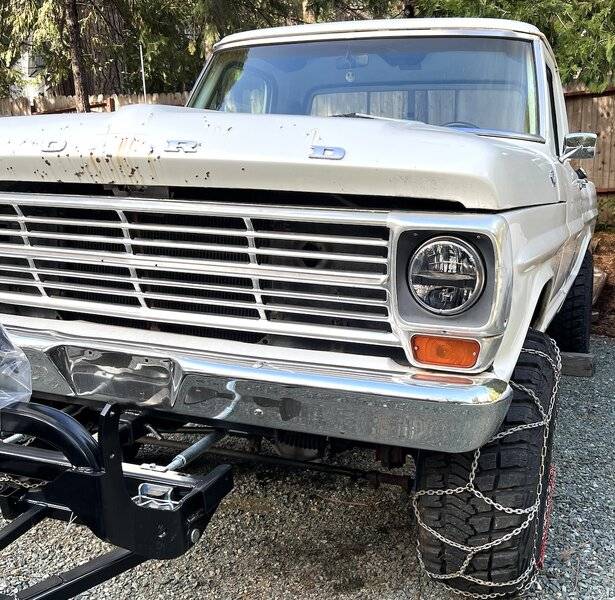

I actually think they look pretty good in person, I’ll take a picture of my truck and post it up. They don’t look original, but they don’t look out of place in my opinion where some of the other LED headlights that look nothing like the original lights can definitely look out of place in the wrong kind of build. I love the look of the JW speakers on my Duster, but it has a pro-touring vibe to it, not original.
Here they are in my Duster. Not great, but not horrible in the blocks department, but man do they throw a lot of light!
Looks are a matter of personal opinion, of course. Personally, I think 72Duster440's car looks appropriate with those headlamps, and the similar-looking Truck-Lite 27s in @j_anderson 's '72 Dart (pics) look at home in that car, too.
