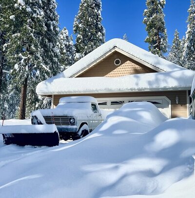

This year has been alright so far, the last two winters kicked my *** with all the snow. I’m at 3,500’ so we definitely get snow, but usually we don’t see much more than a foot at a time and typically it’s more like this year where we have a storm and get 6” and it melts within a week.
Last year we had 3’ at one point, and I blew the spider gears out of the Dana 44 in my plow truck. My Duster is on the right of the Ford in this picture from last year, before I dug it out. All the snow on the Ford was from overnight. And that’s a ‘71 ford lifted 4” and on 35’s
That’s an ‘02 Dakota 5.9 4x4 under there
