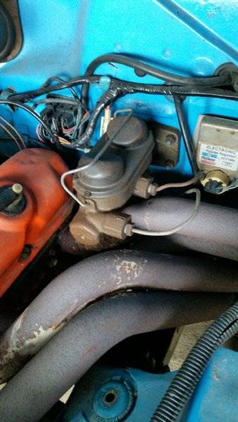

The master cylinder in my big block dart is TOO close to the headers for my liking. It has to be boiling the fluid. What can I do to remedy this? Is there a shield made for this issue or anything? I know they have the offset adapter deal but im not using the newer 2 bolt master cylinder being I have manual disk brakes with the old Kelsey hayes setup..

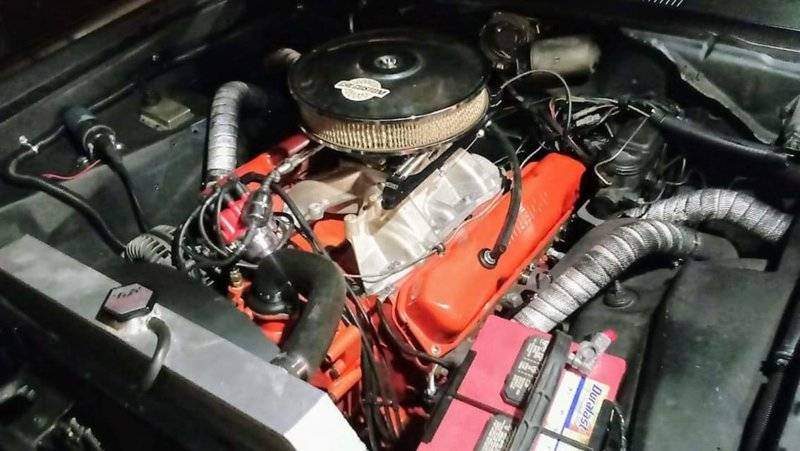

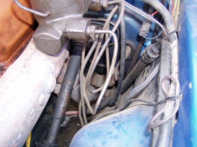

35,000 miles on this setup and never boiled brake fluid. Driven in temps over 100 and have put 600 miles on the car in a weekend. Yes, it's an iron manifold, but it's still very close to the master.
35,000 miles on this setup and never boiled brake fluid. Driven in temps over 100 and have put 600 miles on the car in a weekend. Yes, it's an iron manifold, but it's still very close to the master.View attachment 1715317872
are they touching? dang thats close. id be worried about motor mount flex evetually wearing out the MC mount studs or similar.

The master cylinder in my big block dart is TOO close to the headers for my liking. It has to be boiling the fluid. What can I do to remedy this? Is there a shield made for this issue or anything? I know they have the offset adapter deal but im not using the newer 2 bolt master cylinder being I have manual disk brakes with the old Kelsey hayes setup..View attachment 1715317592
heat shield and DOT 5. not hard to convert to DOT 5. just flush with well with alcohol and refill with DOT 5.. that voltage reg plug looks close enough to melt too..
already using DOT5..what do you mean by 'no shock'? Do they sell a heat shield specifically for a BB A-body with fenderwell headers that bolts right up?
There’s no shock in the hole in that picture.
Don’t think there is a specific bb abody heat shield but they do sell them for the master cyl. Mancini maybe?
Though looking at that pic there might not be enough room for a heat shield.
