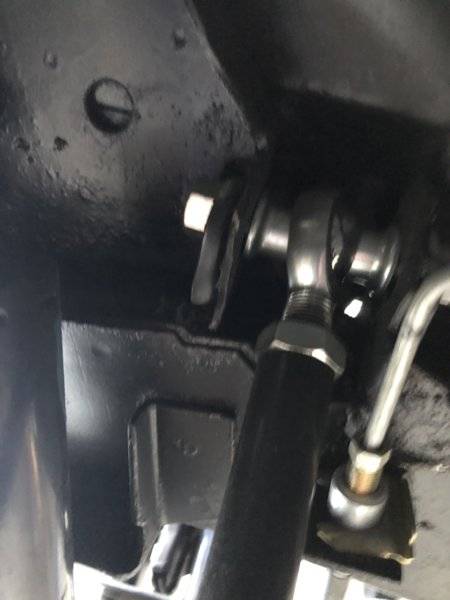

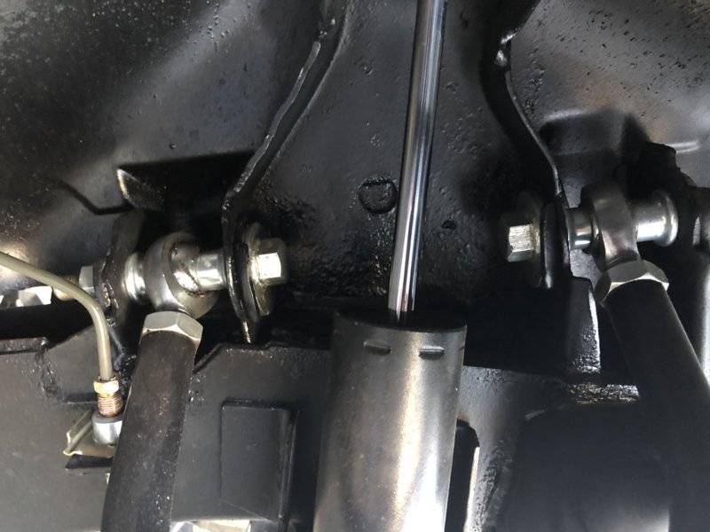

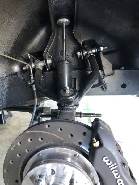

Recently installed PST adjustable UCAs, I am not sure I sized the arms lengths correctly - looks like the balljoint is at an angle. just doesn't seem right to me
The car has been in for alignments and drives fine. Nothing from the alignment shop
I have the car partially apart and want to make sure about these? Or put my mind at ease

I assume you are talking about the adjustment of the heim joints on the UCA mounts?
What was the specs that the alignment was set to? I would think that would tell you if they are where they need to be. If they are both in too far or out too far, Camber would be off. If one is in or out more than it needs to be, Caster would be off.
I would think you would want to adjust them so you have somewhere between 0-1 degree of negative Camber (depending on how you intend to drive it), and have them adjusted properly front to back to have a good amount of positive Caster (2-3 degrees or more).
That might be because you have the suspension hanging free, put a jack under the LCA and raise it up to load the suspension and see if that angle changes.
I would also want those heim joints 90* to the mounting pin.
I'm certainly no expert on these, lol, but those 2 things jumped out at me.

That’s not what they said. The ball joint should be at an angle, that’s your caster.
The heim joint on the front leg of the UCA seems like it’s excessively angled. That would mean the heim might run out of range as the UCA moves through the suspension travel. If the heim binds up before the UCA hits the bump stops you’ll trash the heim and shorten its life. The heim should probably be closer to vertical. But, you have to check the heim through the entire range of suspension travel. It may be maxed out in the picture, but, that may just be because the UCA is on the bump stop (the travel is also maxed out). It’s not ideal if that’s the way it has to be, but with some cars it may be necessary.
Do you know the actual alignment specs? Because that would definitely help us evaluate those pictures.

I thought about that too, but I would think it would be more important to have them parallel to the lower control arm. Not an expert here either though.
90* to the pin isn’t always possible, and it’s not absolutely necessary. But you do have to make sure you don’t exceed the angle range of the heim as it runs through the entire suspension travel range. You don’t want the heim to bind up as the UCA runs through the available suspension travel. Heims have a misalignment angle tolerance, you just have to make sure yours operate within their range.
That's what I was thinking Blu. Thanks for clarifying! My thought pattern was that they need to aligned with the plane that the LCA travels in (or at least close) so they don't bind as the UCA goes up and down.
The simple answer is it looks to me like the heim balls are bound or about to bind. Outer part of heim should be perpendicular to the pin. Moving them should not affect the alignment enough to worry. They should all look more like this
Again thank you for the help - my focus was on the balljoint and not the heims - I will work on those

I would serve you well to grease those Heim joints and get covers for them.
I did not - the car is still apart. during the reassembly I will work to correct those. And re-crease them. Never thought about covers - i will also look into those
