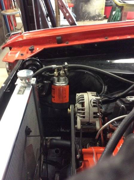

I'm sure this isn't a novel idea, but here's the question:
My oil filter is being cooked by my headers. I thought about putting a heat shield sleeve on it, or maybe relocating the filter. Then I thought, well, if I'm gonna relocate the filter, why not run the oil through the trans fluid circuit in my radiator. I have a 4 speed, but the new radiator I got has a circuit for trans fluid that is currently plugged with bolts. If I hafta run hoses anyway, should I run the oil through the trans fluid circuit?
Are the ports in and out too small?
I don't even run the transmission through the radiator any more.
The issue with remote mounting is the length of the hose and all the fittings needed. It reduces flow and adds more places for a leak.
Don't know what you have for headers, but I'd rather have a 90* adapter than remote mount the filter. Unless you are going to run a minimum of -12 hose and buy hose ends with a radius rather than the tractor fittings I see some guys use.
Thanks y.r.- I'll check clearance for the 90*.
Are the tranny coolers rated for 80+psi? I know the cooler lines are under minimal pressure from the trans as they are just drain back lines. Also even the VW coolers use 1/2 inch tubing, let alone the 5/16 connectors used. I think the trans lines in the rad are alot smaller than that for volume to a V8. You could wrap the header pipe with Header wrap, that stuff works great. Some say it will weaken the header under its extreme heat retention but I wouldnt worry about it.
