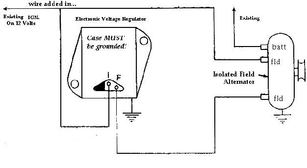

I' building a wire harness for the race car and I'm confused about the Alt wiring.
I have a 3 wire alt.
So big black wire to battery.
Then next to that is a blue and a black wire on one space.
Next to that is a green wire marked field.
My understand is one wire (green) "field" powers up the magnets and is the on off for the Alt.
The black and the blue wire are What?
With a race set up. No ignition switch, just a push button and a toggle for the msd. How do i wire the alt?
Green wire to the toggle (ignition switch) ?
Black and blue to the hot wire feeding my gauge cluster?

Assuming you are talking about a Mopar without an internal regulator (Delco, etc) blue comes from on/off switched ignition and powers the field. Green hooks to the F terminal on the regulator. The I terminal on the regulator then goes and "Ts" into the switched power. VR MUST be well grounded to "same as battery"
this?
Ok thanks. I was wondering what box was on the fire wall. I was about to toss that sucker in the trash. Glad I asked. :)
