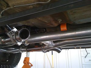

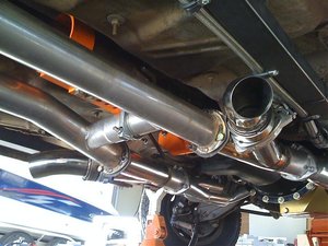

To burn up some time I installed the Exhaust Cut outs, just finished them this morning........ I got exactly 18 " to the atmosphere from the collector!
Sounds Bitchen with them open! I also like the idea of flipping the switch and running FULL EXHAUST.....quiets it up a bit for sure!

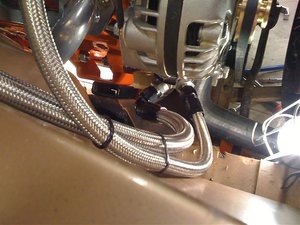

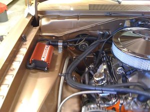

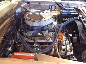

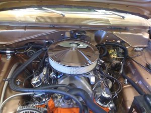

Here is the engine in the car......
I will be installing a small NOS system in a few weeks. I will buy the bigger unit and jet it down for a 100 Shot is all. I would rather have the bigger solenoids for a later date.
looks really good my friend! looks really good....by the way, i know i read it some where on here, can you please tell us the power it made? and, id love to hear a video!
Thanks, It made 507 hp at 5700 Rpm and 504 Ft lbs at 4800 Rpm. It has some pretty good low down torque, the test started at 3000 Rpm and it was already making 424 Ft lbs of torque. The plan is to get it all to the ground. Numbers dont matter if you cant hook! It made the most power with a Holly 1000hp carb. I made a few adjustments to my 750 Mighty Demon that was running lean, if anything it is FAT now. I will know later today after I rev the $hittt out of it in 3rd gear and pull a plug!
