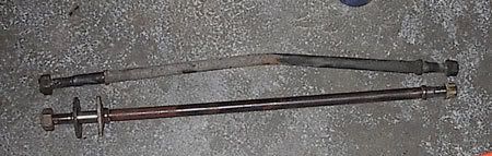

Just started to clean things up then I discovered that the strut rod is bent right were it goes into the controll arm.Feeling sick right now.Can this be straightened or is it junk.what do I do.
They can be purchased new. Even in aluminum if wished. Check the suspension places or Mancini racing. You should have no problem in getting a new pair and the bushing.
Snake if you need one I have a pair I'd let go real cheap. Their already painted with POR-15 gloss black. I just upgraded the front end on my Cuda with tubular A-arms and dynamic strut rods so I have my stock ones that are fine. If your interested I'd let you have them for $15 plus shipping. Just PM me. Tracy
Hi Snake, if the ones from Fishy68 don't work out, I have one that's in great shape that's available. Clean and painted. Fishy68 was first though.

Not sure what to do right now but i will keep it in mind. thanks for the help tho.I called my mopar mechinac who help get the front end apart he says no big deal we will put it in a vise and strighten it out.I must say this is the last car i restore from now on i will buy one somewhat done.

buy a new set. they aren't expensive. i got a beefy set from just suspension for jamies car when i did the front end.

Get a new one.
Mine looked like this when I bought the car. The previous owner was driving it around with no strut rod bushing!
Problim solved.I got one from a place were i have been buying all my stuff.Thanks to all.PS I am over being pisses at my car.Your right Red buying one done you dont know realy what you got.
