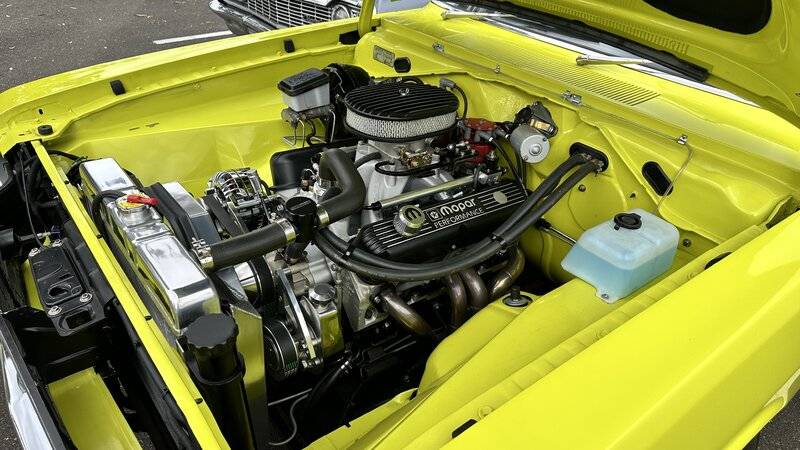

On small block or big block? If it was a small block, did you have issues with the windshield washer motor and distributor?
Small block, no issue with wiper motor but I got lucky as my car is RHD! Did change the rotor to an MSD adjustable type unit to get phasing correct as this was an issue with early PF4s which I believe has now been corrected
