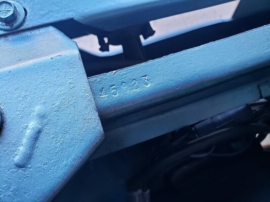

Rad support VIN.jpg*
My core support. 145923 is the serial# of my '71 Demon (also present on the engine block, gearbox and under the package tray.
The complete VIN is only present on the fender tag, the dashboard and the passenger side inner fender.
