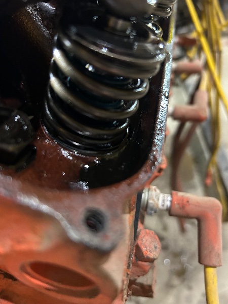

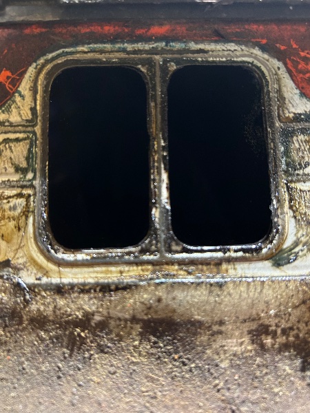

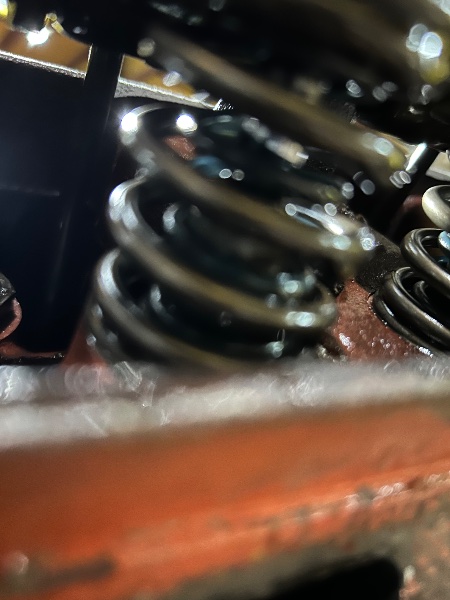

I pulled the intake and valve covers and found something interesting. I knew the 906 heads and Torker 383 intake were ported and polished but what I didn’t know was the ports were coated with some kind of epoxy? It’s black or very dark blue. It looks to be painted on with a brush. The ports are very smooth. The intake is totally coated inside. Looks like 10 degree retainers and skinny wire springs I’ve never seen b4. My buddy figures their a Chevy spring. Keep in mind these were done 30 years ago. Kim
Thanks for the insight. Wonder how much of an improvement it makes. Sure couldn't hurt.
I found out who did the heads and he is very innovative guy. Warren Johnson was his idol. He tried to copy every last thing the professor did. He learned a lot from Warren. So maybe it’s an d pro stock trick that Johnson employed. Kim
Sounds like a balance between keeping the suspension and keeping the flow.
