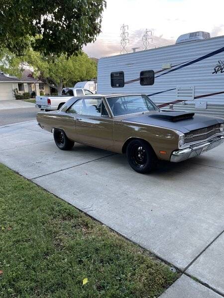

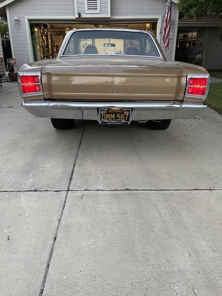

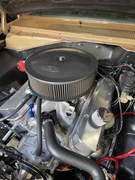

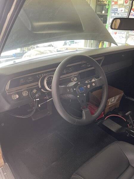

A few pics...dirty as it is...
The car is a Frankenstein of a combo, I will admit...lol. The converter was on my shelf, bought a few years ago for the mild 360 that was originally planned for this heap. After talking to TA, it was decided to try it behind this motor for decent street manners. Same with the 3.55’s, as it’s destined for 95% street driving. The end goal was to drive the 130 mile round trip to the track! We’ll see how that goes. At some point it may get a cam with about 15-20 degrees less duration though...
130 miles round trip driving to the track and back?? Props to you for doing that....my main concern for not really wanting to do that is the subsequent damage that comes from being on the highways that long.....rock chips, running over something in the road, accident with huge delays, etc.
