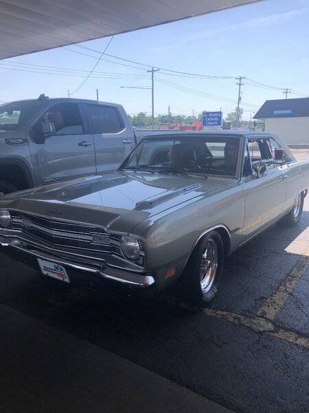

Street/ strip duties...
A stop at the Root Beer Stand in my town here today

The factory hood might be my favorite part of the whole deal.......just awesome considering how well it performs but yet looks essentially stock
everything I have ever had I have tried to keep stealthy looking.
Don’t like big tires, fiberglass, gutted interiors , etc, etc.
Same here and although the Barracuda has a Hemi style hood on it the Demon will retain its factory hood and interior along with the '68 GTS

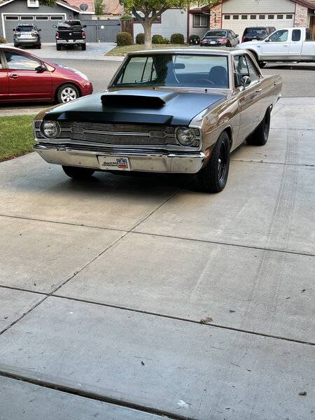

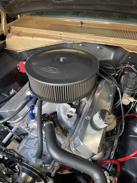

I’m going the street/strip route with this:
440 small block (4.25 crank/4.06 bore)
R3 block
Rod Bloomer stroker kit
10.5:1
Indy 360-1 heads
T & D rockers
Indy intake
1025 cfm 4150 carb
Comp solid roller:
.700/.672 - 270/276 @ .050 112 center
Pro built 904 with the best parts
Turbo Action reverse manual valve body
Turbo Action 10” 4200 converter
8 3/4 rear with 3.55’s, Strange spool and axles
2 pass side SS springs
Springs moved in
Mini tubbed
Frames tied
CCP tubular upper control arms
CCP front disc brakes, 10” drums on rear
Will test with a g-meter soon I hope, but will make some 1/8 mile hits at TNT in the fall air.

Sounds like it'll be a hoot! I'd look at another converter, mine flashes 5600 and honestly I think it would work better if it was 6000.
